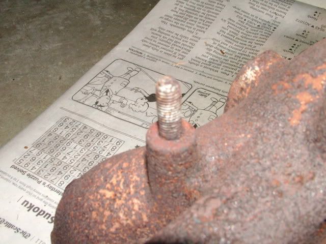

There's a stud on the drivers side factory manifold that helps hold the pump bracket.
Randy's concerned it is needed and what to do with it if headers are used.
GBRandy said:
OK.... But how come some Brit back in the late 70's decided that support bracket was necessary and now some hot shot Amereecan says we don't need no stinkin bracket?

You won't need the rod, but if you still feel the need to have one, I suggest bending up a new support rod that mounts under one of the header bolts or to the engine mount bracket. I just finished fabricating a new set up to locate the power steering pump on a friend's car. He has a Buick 215 timing cover and lots of shiny pulleys that prevented using the stock brackets to locate the pump. Boy it gets tight under there in a hurry.
Yeah, I thought it was overkill, and it sure makes adjusting the belt a pain!
