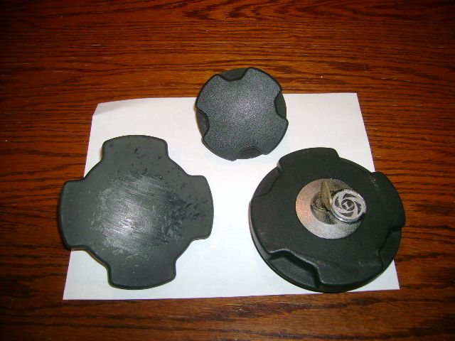

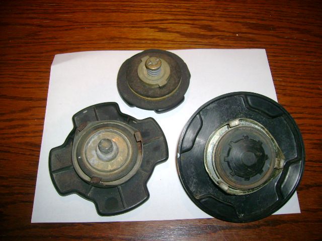

Todd, do you have a picture of the differences between the small and the larger caps? You're the only one here who would have access to both.
The large cap looks like the small cap.
Only larger
Only larger
Actually, the small cap looks like the large cap, only smaller :smile:
Pictured on a 9X11 sheet of paper for scale. The larger caps are solid plastic. The smaller caps have a foam skirt around them, or at least they did originally. Note the factory locking big cap. Pretty cool eh? The smaller caps have two locking tangs and the bigger caps have three.
