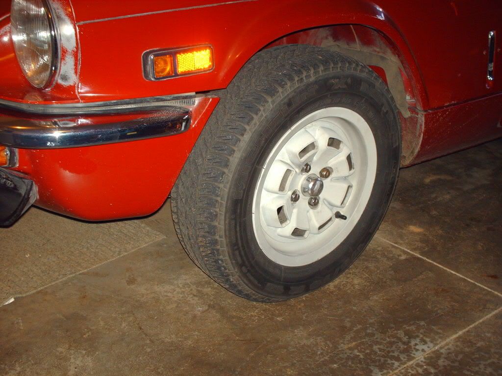

I personally chose to swap wheel studs, as my wheels came with lug nuts. That was a frustrating exercise, as the web listed recommendations don't fit worth a darn. I really should have just bought new lugnuts from one of the above suppliers.
