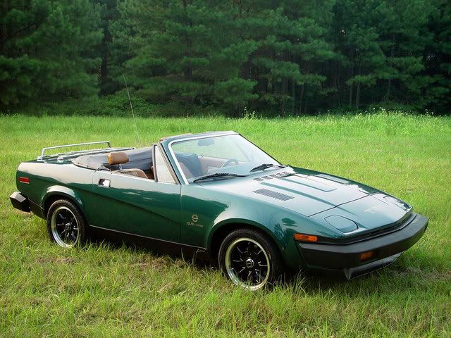

Does anyone recognize these wheels?
I decided I like the looks of the black wheels with the green.
I was planning on something like this
Whats the group decision
They are Panasports.... I beleive panasports are offered in silver, gold, and black. I was thinking that black would look good on Sinister8
What do you think of the 5 spoke in black. 15" They are MGF wheels.saw them on another car.
I purchased Konig Rewinds for the TR6. The ones I purchased were all silver, but they also make black with polished rims - gold, too. See picture below. The center hubs are flat so you can buy the Triumph center hub decal and apply it to the surface. I have the decals, but waiting to apply them until after it comes out of the shop. Also, they are about half the price.
For the TR7, I would like to increase the rim size from 13 to 14 or 15 inch, but don't know the offset yet or the tire size I will need. I need to research that. I want to buy another set of Konig Rewinds with the black centers and polished rims.
