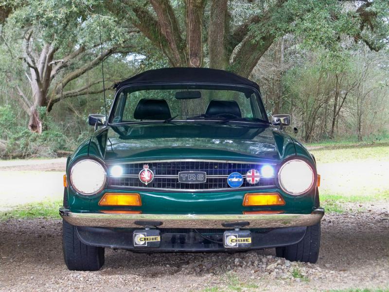

My replacement came from Moss...'solid tinted' about 180 bucks
The tinting is very light, but noticeable:DRL 004.jpg
^^^^ Handsome TR6!
