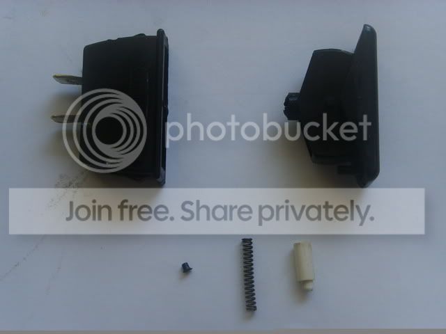

Ok, I got it apart. Now here is the inside. What I want to know is what is suppose to make it spring back?

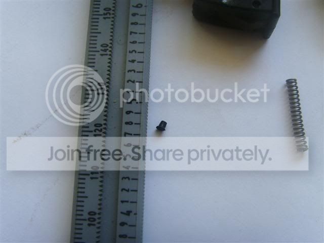

Also What is this little piece???

Great work DNK. I believe the "return" spring fits on the plastic stud I see at the bottom of the front rocker in your picture. It doesn't have to be too strong, maybe use half of a spring from a black government Skillcraft pen...

Jeff- All that spring does is center itself inside at the pivot. I don't see how that would cause the rocker to push back(center itself)
Roger that. The spring in the picture does that. The spring you're missing goes over the plastic post I can see at the bottom end (in the picture) of the movable piece. You can probably fashion a suitable spring from a cheap retractable pen.

Jeff I thought of that but that post is on the bottom of the switch. If you push the top down the spring will keep it there???
I'll give it a shot.
Hmmm - maybe the post is there to keep the switch parallel while a 'return' spring pushes out at the other end. Is there something at the other end that a spring could fit in? Maybe someone with a spare switch could look at the top end to see if there is such a spring.
