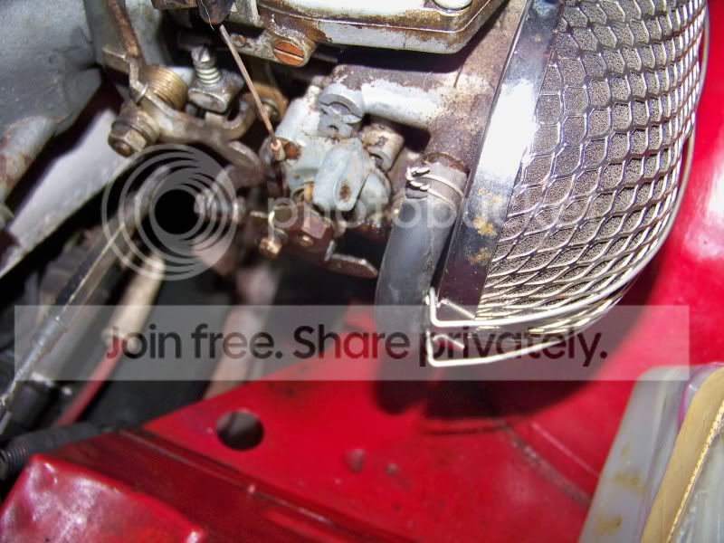

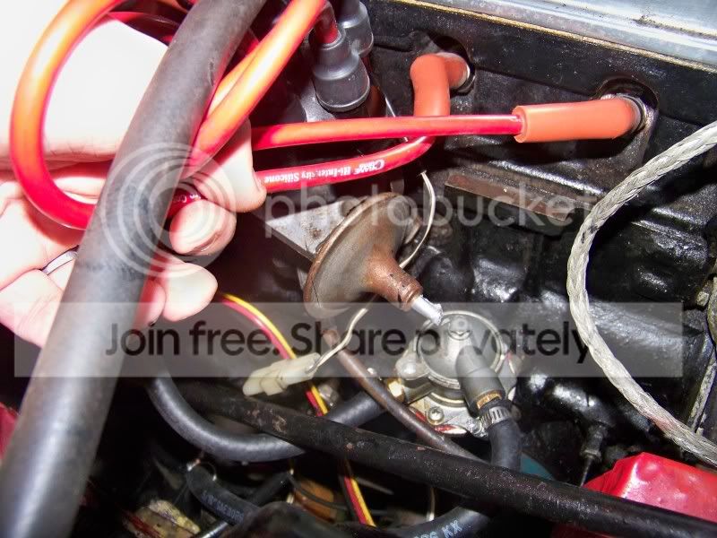

My professional job of plugging the module off the dist.

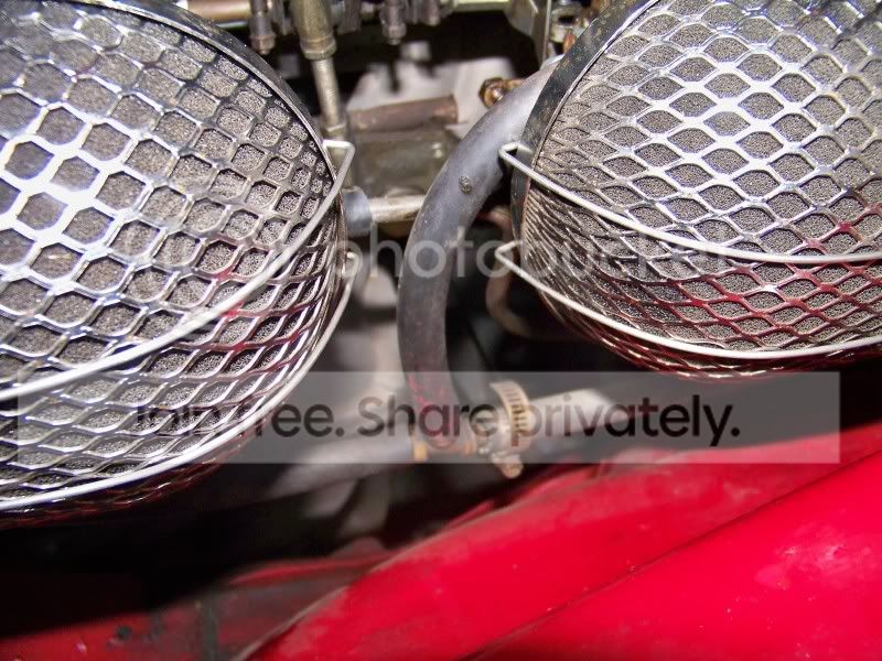

These are the vacuum lines you are referring to off the carb?
... that lead to the emissions canister in the front right of the engine bay?
Neither of these hoses cause a increase in rpm's when disconnected?

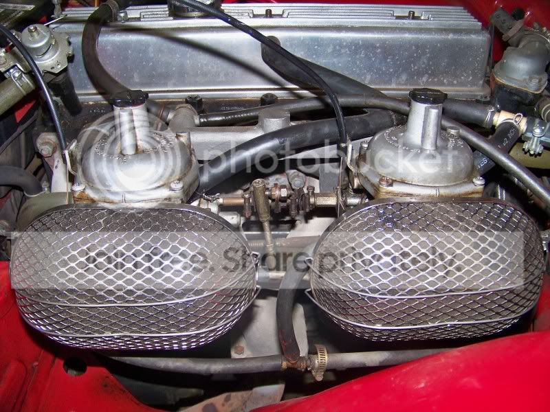

Could you take one more picture that shows both carbs in the same picture from standing height? Maybe the other guys are already past that, but it would help me 'see' how she is currently set up.
My guess is that those carbs could benefit from a rebuild, which really isn't that hard (heck, I even figured it out with lots of help from Paul and Poolboy).

The two thicker tubes from your post above should go to a black canister near the front of the engine bay, they are there to catch fuel vapors and should remained connected when you are tuning.
Re: TR6 TIMING QUESTION...........................
There is NO need to plug the NIPPLE on the retard unit. It Does Not generate a Vacuum. It is designed to RECEIVE vacuum from the rear carb's nipple that you just discovered. (Sorry about the "caps" but I seem to be having trouble making that point.)
The hoses that you are highlighting in the photos are not vacuum lines per se. They are ventillation lines and also the conduit for the Anti Run on Valve, but I think it's premature to get into the explanation of that system.
