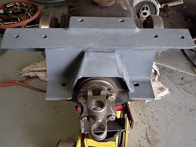

I found the BMW differential to be a great choice. I bought 2 LSD units for less than $200 off Ebay. Right now I'm running the 2.93 gears. It takes off really nice and gets me over 20mpg when I'm not acting out my youth...
I was amazed how easy it was to install. I also took out the rear shock bracket and replaced it with 1x4 inch square tubing- which the diff back torque mount is bolted to.
The 6 bolt to 4 bolt steel axle adapters cost me $300 at a local machine shop. UGH.... I'm thinking about going to something in the high 3 range if the price on Ebay is right. Far as I'm concerned the BMW differential is the way to go.
