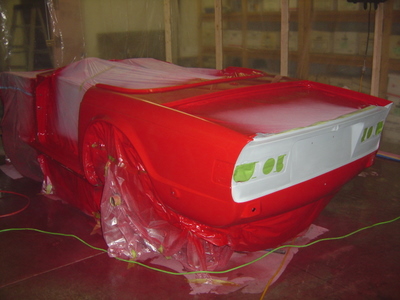

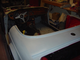

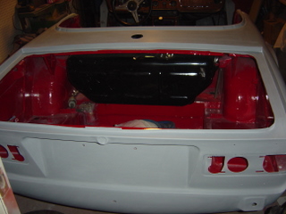

Well guys the painting journey is comming down to the finish line, every thing is painted, wet sanded, polished to a high shine, and all that is left is the body. Door jams, Rear fenders, back end and front, I finished the wet sanding yesterday in the wonderful 70 deg weather, went over and over everything and filled the few tiny spots left. So the plan is on Friday to rent a trailer, get the car over to the paint booth, and Spray the rest of the car on Saturday!!!!! I can see the Light at the end of the paint booth. I will post a few pics later on of whats left to paint and then a few after I am done, Then the process of putting everything back together. that will be the fun part
