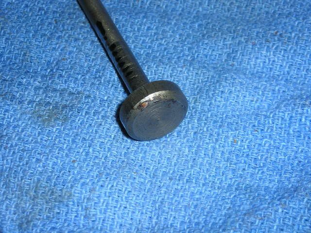

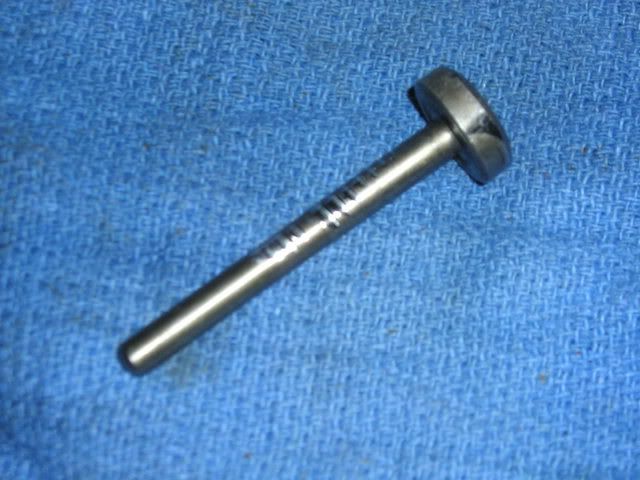

Placed a second washer into the relief valve piston stem. Drove it. Higher
pressure for longer period; oil pressure reduced but not as low as before.
Still not quite right.
Pulled the valve. Check out what the piston looks like now. It's
scored. Maybe it hung up on the washers??? Funny, because the ultimate
end result was the same as before the washers were placed. This thing
acts like it builds the pressure; opens and never fully closes allowing
pressure to be bled off.
Parts were supposed to be in today but didn't come. Just ordered the
piston and spring. Now thinking maybe shoulda gone whole hog and got
the valve housing as well. We'll see after I try the new parts.
This valve piston certainly creates question, doesn't it?
This thing looks like if it wasn't hanging before I "washered," it, that
it certainly is now, doesn't it? I dunno. We'll see. Saga to continue.....
Is that an illusion or is the shaft showing scoring from the spring's coils ?
Poolboy: That is definitely scoring. It does look very much like it follows the
pattern of the spring coils, doesn't it? I don't know exactly what is going on.
I suspected it could be possible that one of the washers I had to "custom fab"
on my grinder may have slid down the piston stem and caused the thing to hang and
score.
Thing is, the symptoms the car shown after the washer placement were the same or
similar to the symptoms shown prior to washer placement. I keep coming back to the
nagging feeling (or not so nagging....hope springs eternal.....) that the seminal
issue presently at hand stems from this relief valve.
So replace it already???? Yeah. I'm waiting for the parts....and the washer
thing was an interim look at things and it made me all the more suspect.
That piston sure looks weird, doesn't it? Hope the valve body itself is not
playing into this...I only ordered the piston and spring. I figured, what the
heck could go wrong with the body? But, then, you never know.

Seems rather obvious something about that valve piston looks bad from the pictures I've posted, wouldn't you agree?

Since your oil pressure regulator piston is damaged or at least warn, get a new one and spring for less than $20 overnight. At least you can eliminate the up down pressure is being caused by the piston and spring. I suspect a PO worked the piston and that is why it has those marks; nothing but oil under pressure is around it under normal use.

The spring marks around the shaft are puzzling, but the pitting or wear around the seating surface might have been caused by debris floating around in the oil. Stuff like bearing material, metal shavings, whatever, who knows.
