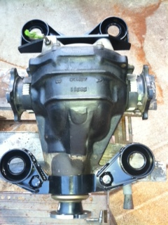

well got the drive shaft back and the brackets for the R200 differential on
see the pics, the new axles are here, so pulling the CV shafts out and replacing the axles, then its all back together this weekend, wow between boating and the car, I will be busy plus meeting 2 ladies this weekend

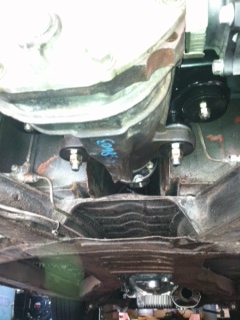

Ok the R200 unit is in place, what a great kit, it fit up perfectly, and Richard machined the pinion yoke and if you look at his directions he also reduces the diameter of the yoke to match the original drive shaft flange, so Bobby maybe thats why you had some rubbing issues. I had to replace the axles on the CV half shafts because the set I purchased were for the original differential, and the axles for the R200 are a tad longer,( I will be sending the other shafts back and the adapters so richard Good might offer a discount on his kits on used parts) Replacing the axle was a little difficult on the first half shaft but a breeze on the second one. here are some pics. all I have to do is put the exhaust system back on.. I think I am going to weld the whole thing on I am tired of clamps

Well I got the exhaust system back on. That was the most difficult part of the R200 conversion, I had to do a lot of modifications to get the system back in without hitting the differential or the frame, I am sure glad I bought the MIG welder. I have the Monza exhausts with the twin chrome tips. I really didnt like the look of 4 tail pipes so I cut the inside tip off of each muffler, welded a cover over the holes and now I have dual exhaust, see the attached pic

Hondo,
When the opportunity arises, like if you're under the car admiring your work. or if you have a wheel off for some reason, please do me a favor and tell me how much room you have between the top nose ridge line of your R200 and the lower lip of your front bridge. You'll recall that I've got a whopping 1/16" or so.
Thanks and great to hear how it works and runs. My experience is exactly the same, without the 200 hp. All that's left for me is to chase down a thump here and there.
Hey one other question. When you tightened those lock nuts on the adopter for the R200 mounting, did you have bolt thread to spare? For me I barely got through the nyloc part.
Thanks
I see the pics now. Looks like you had lots of thread left. The TR6 kit may be different from the 4A kit.
