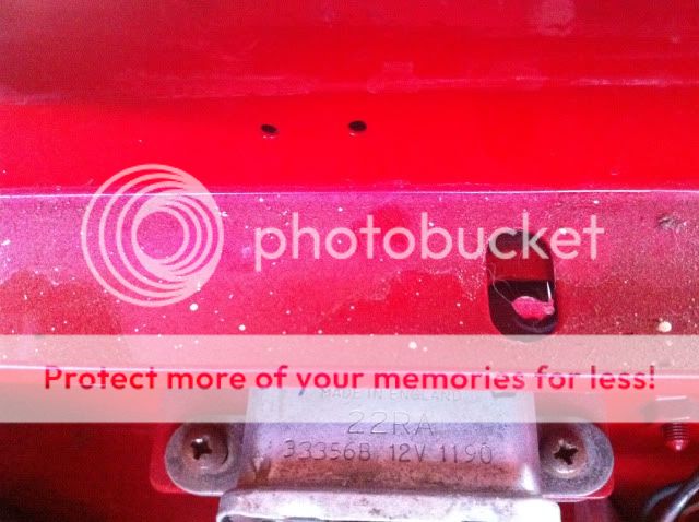

Each of your front fenders should have 4 small holes (2 sets of 2) on the inside of the fender. The wedges are mounted there. TRF plate FD item #55 shows them fairly clear. I can dig some PICS. I can tell you that the LH rear one is right above the horn&hazard relays.

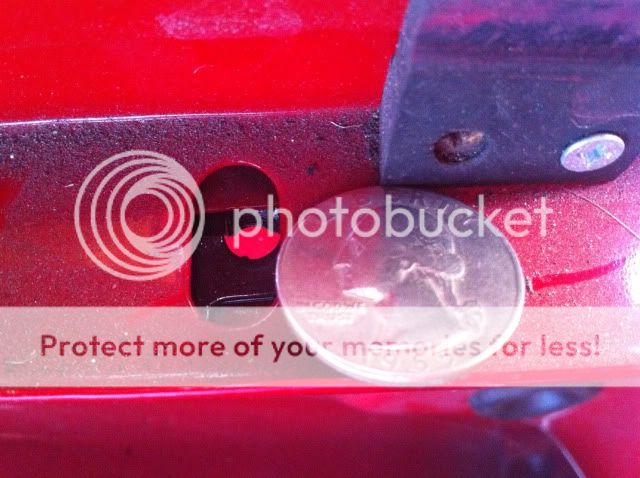

A little dusty but work still in progress :hammer:
This pic the wedge is towards the front.
The holes on the other fender are in the same place. Hope this helps!!
Absolutely perfect. Thank you TR4dude for the pictures, all guys great help. I do not have the four pairs of predrilled holes, but I can now easily mount my own. Thanks.
