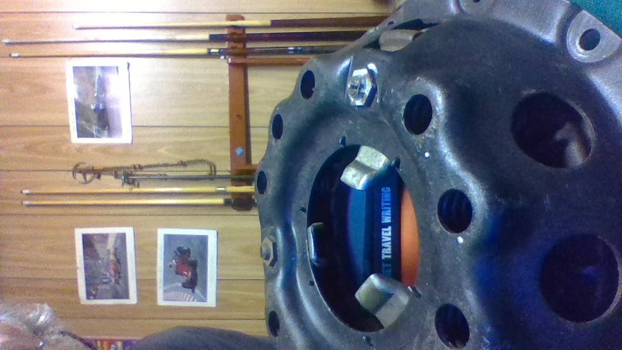

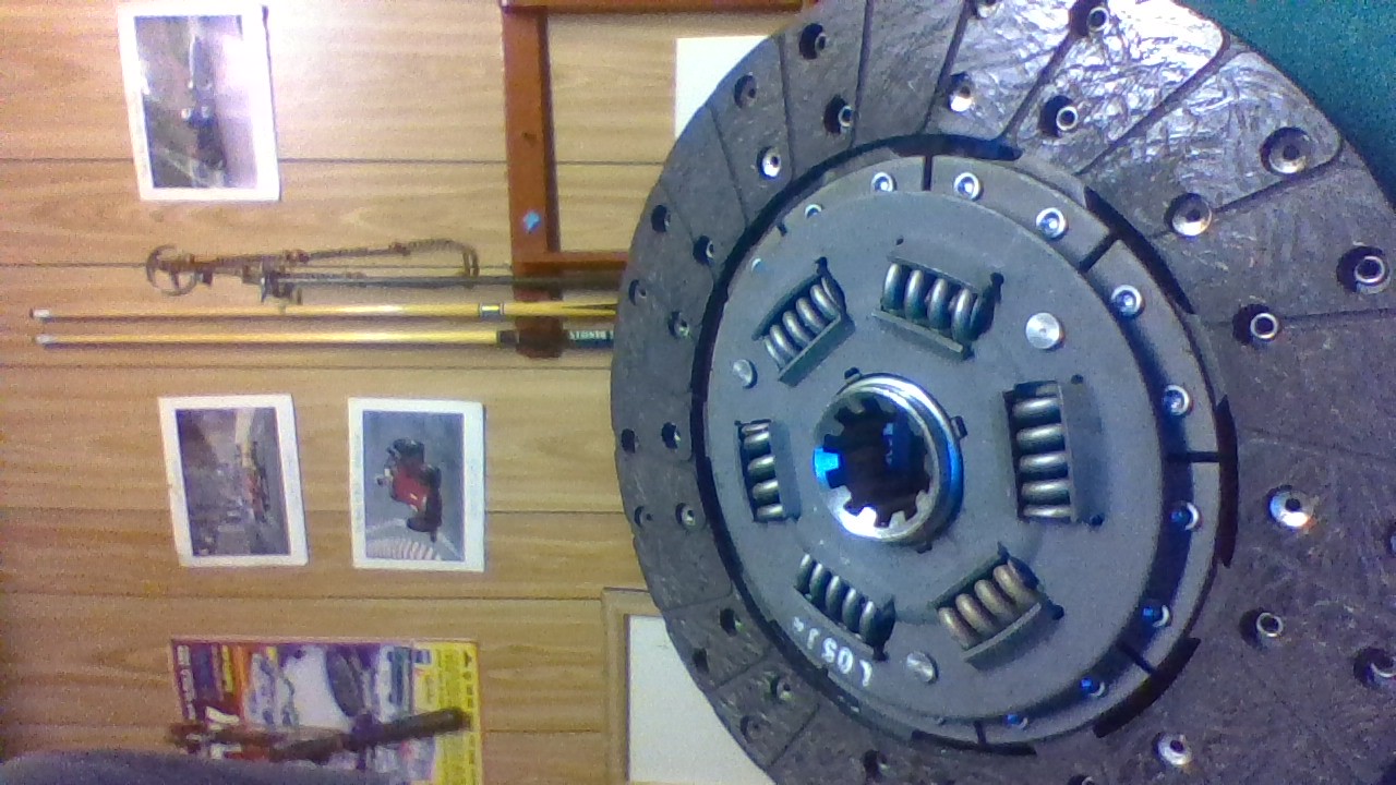

It's time to replace the clutch. I have been using the TR3 pressure plate type that has the "3 levers" (see pic). Anyone on here running a TR6 box in their TR3 and what clutch did you use? Is it even possible to tun a TR6 clutch set up? I do not know if the 3 lever clutch type that I have been using is even available now? I do have a new clutch plate and throw out bearing that goes with that type but not the pressure plate unfortunately.
I see Moss and BPNW sell the Borg and Beck type clutch(this type has the pressure plate with "multiple fingers") they are Back Ordered. Rimmer Bros has the complete clutch kit for the TR3 but would that kit fit my TR6 gearbox? Any thoughts?

I don't see the 3 fingered clutch set up for sale anywhere ???? Is it still available? Also I saw an old post by Randall (I sure miss his advice on these old TR3's) where he says: " And the clutch slave will need some modification because the TR6 mounting flange is thicker than the original TR3. I kept the original mounting position (bracket on the back of the flange,slave on the front of the bracket) and made up a shorter push rod to suit; But it may have been better to pound the edge of the cover flat and use the TR6 mounting position(bracket on front of flange,slave on back of bracket.) At the time I did not want to take the slave off the line. I also wound up making a little tab to stretch the return spring tighter(to compensate for the shorter push rod) which the other method would have avoided." The end of Randall's quote Here is what confuses me......When he says to pound the edge of the cover flat for the TR6 mounting position what cover is he refering to? What am I missing here...I can't seem to grasp where this cover is and also if the TR6 position is used does that mean you don't have to use a shorter push rod? If I did go with the TR3 mounting position how do I determine how much to shorten the pushrod? I hope this makes sense. Karl

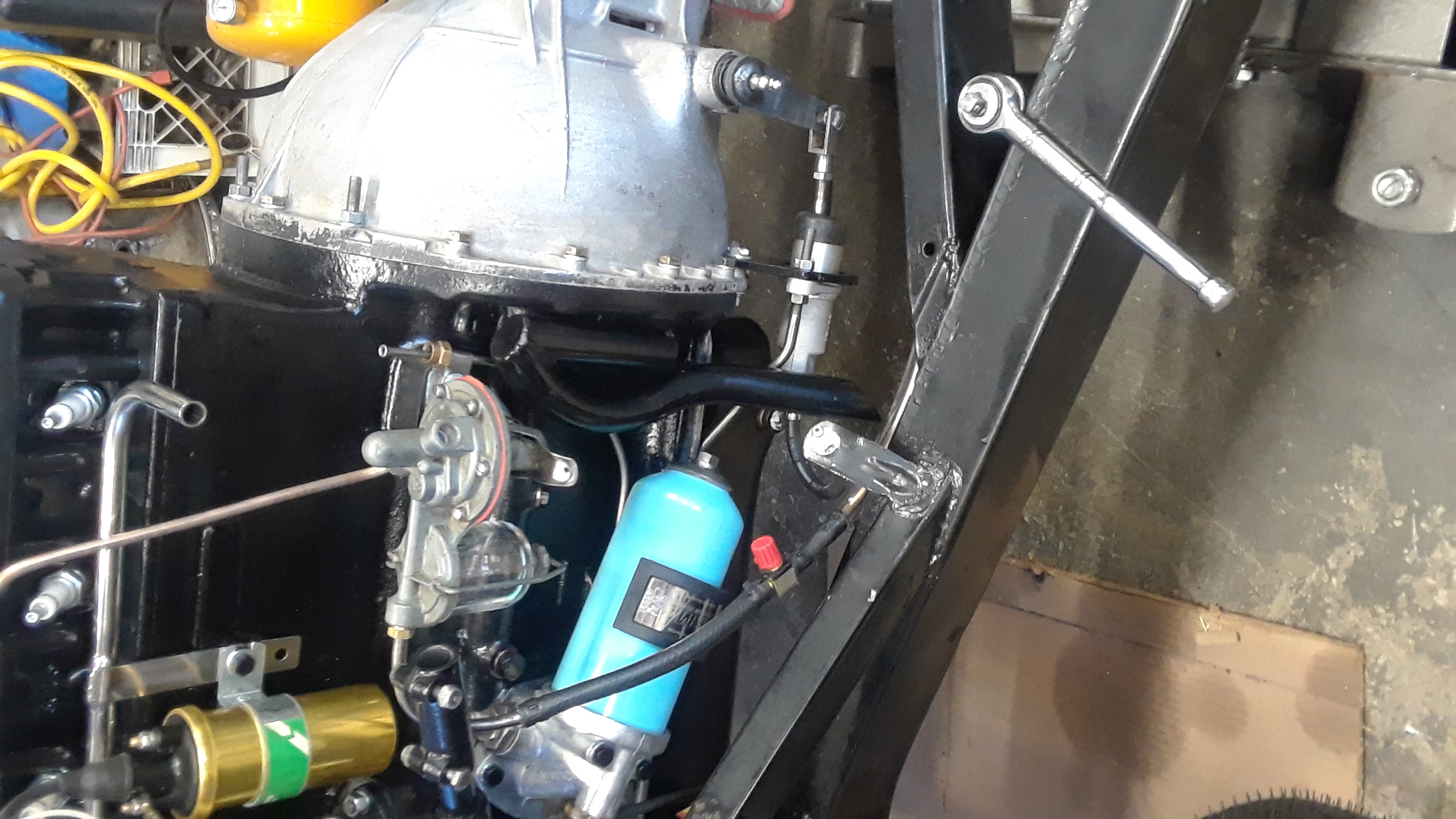

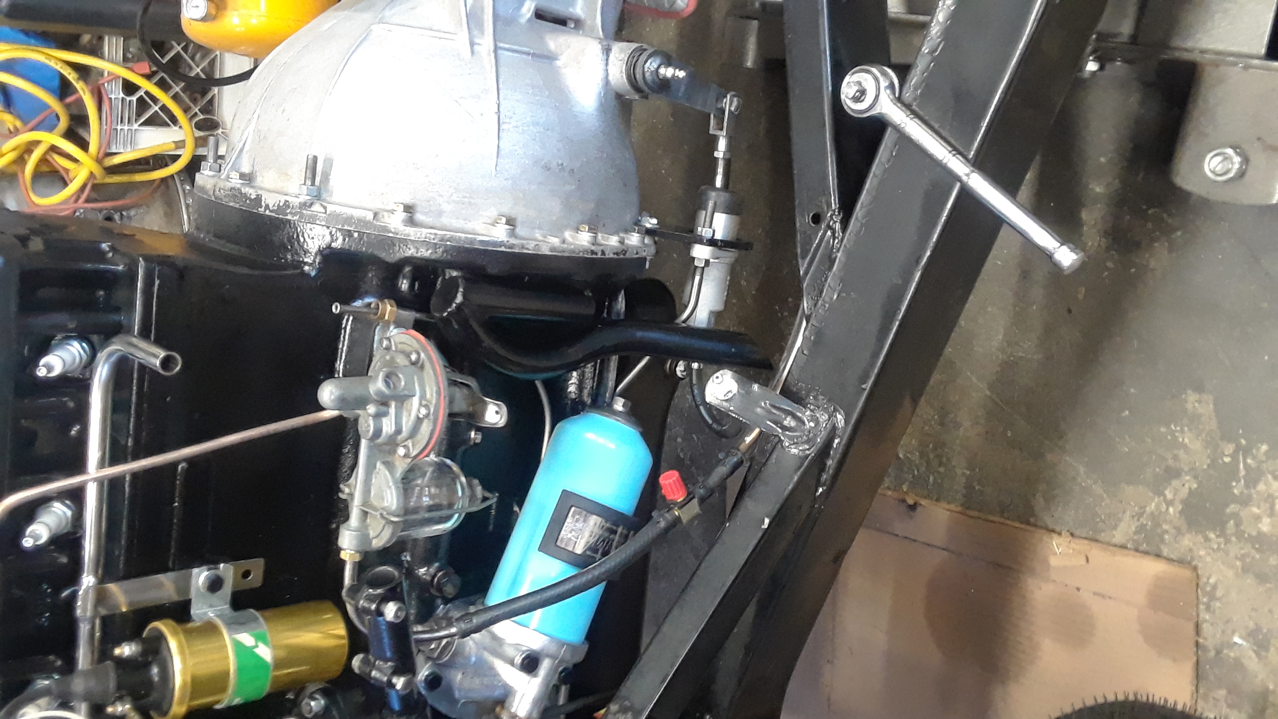

I read and meticulously followed Randall's suggestions about mounting a TR6 tranny to a TR3. This includes using a TR3 clutch set up. As a pic is worth a thousand dollars words here is what the slave cylinder looks like. I used an adjustable rod on the slave and adjusted it to give the required gap.

Caution. The two clutch pressure plates are two different diameters. You may need to have the flywheel drilled and tapped with new bolt holes. Check with whomever you buy it from about the difference in bolting pattern. Have you tried TRF and BPNW those guys know what they are talking about. The one you mentioned usually does not know much about TR stuff. And these are different from MG.

Well I found the problem and it looks like I wont have to pull the gearbox and change the clutch. Thanks to your photo I discovered that I had my slave cylinder mounted the other way around. When I moved it to the same location as yours,behind the bell housing flange, I was able to adjust the clutch so the pedal was at the right height and lots of pressure when I push on it and the gears dont grind. The car shifts smoothly now and goes into reverse easily. It turns out I did not have to shorten the rod as there was just enough room in the rod fork for it to work. I didn't have much luck using the .100 spec for the play so I just left what I felt was enough play between the the rod and the slave piston. I think I just have to get used to where to slip the clutch a little better when taking off in first. Every other gear is no problem.Big thanks for your help Charley. (y)(y)
At your peril do not dismiss that 0.10 play.
As I understand the situation that gives the throwout bearing room to remove itself from the clutch fingers. You do not want the throwout bearing constantly riding on the clutch fingers.
So just make sure you do have some separation.
My information on the slave cylinder positioning came from the late great Randall Young.
His knowledge lives on.
Charley
Charley
