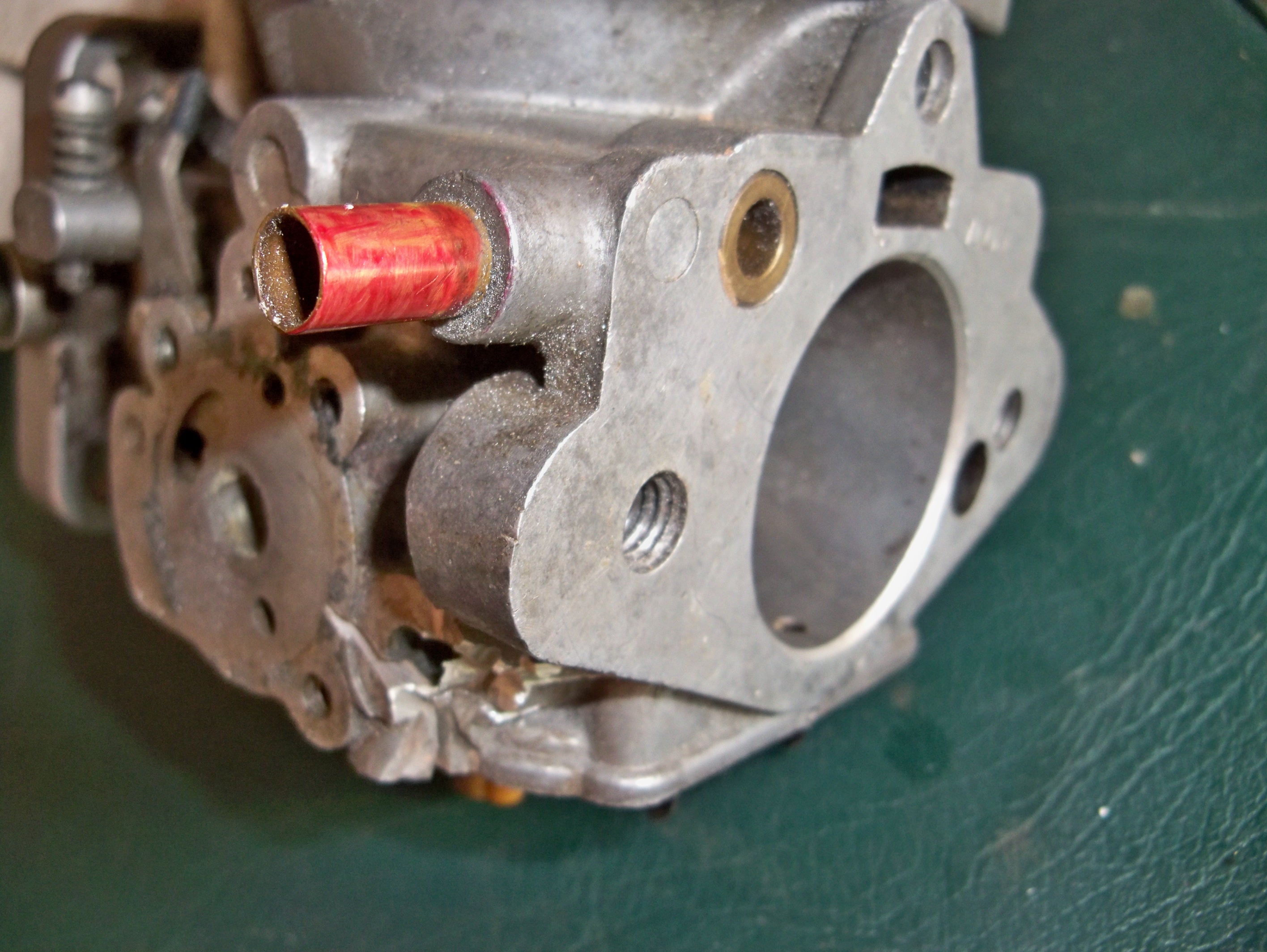

If there were no problems you could "gut" the transition valve and have all the ventilation both at idle and off idle occur thru the brass lined port seen in this picture, like where the pre 73, pre Anti Run-on Valved carbs provided ventilation for the float chambers.
