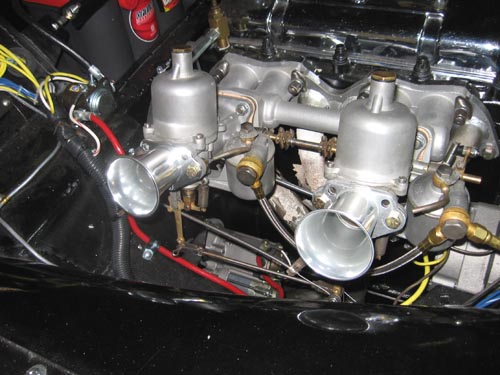

I just have those on for show. I have some socks that fit over them, but in reality, I'll be putting on the original filters, unless I can find an appropriate fluted paper filter. The paper filters are generally the best way to go, which I believe are stock for the TR6.

Been running, selling, experiencing K&Ns for a long time. I think they are great. Probably over rated and over sold, but still better than what usually passes for air filters on much of the older iron. The older stuff would keep out the rocks and low flying birds, but that's about it. Maintain your K&Ns properly and appreciate the look and have fun.
another point of view is you can clean them and reuse them, think of all those paper filters that get thrown away each year, now I am not a tree hugger guy but if I can keep 10 filters out of the land fill each year then I am helping out and I drive a toyota 4 runner with 250,000 miles and I think ir filters just fine
I have had my K&N filters on for several years now and keep K&N Precharger socks on all three of them. Just the other day took them down to clean and re-oil them and there was really no need. They were clean as a whistle. Maybe it was the Prechargers, which are designed to keep dust and water out of the filters. K&N filters are cotton, and do occasionally need oiling.

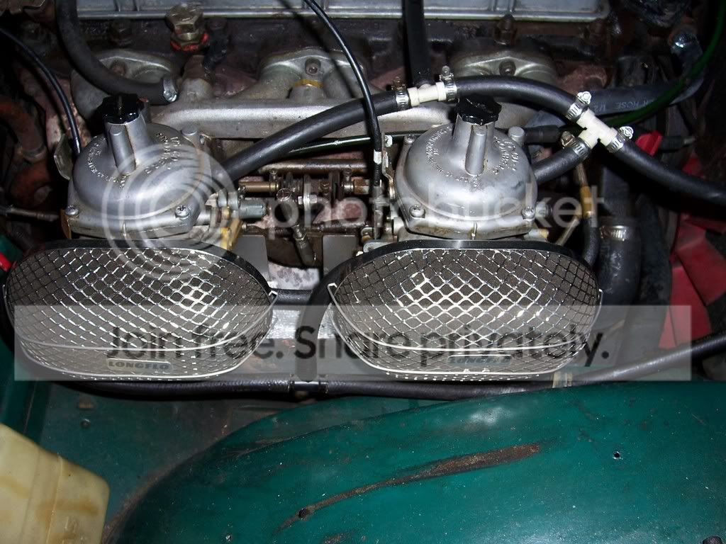

Here's another alternative. Longflo Ovals. They have a foam filter element and although some may disagree, require no oil.
