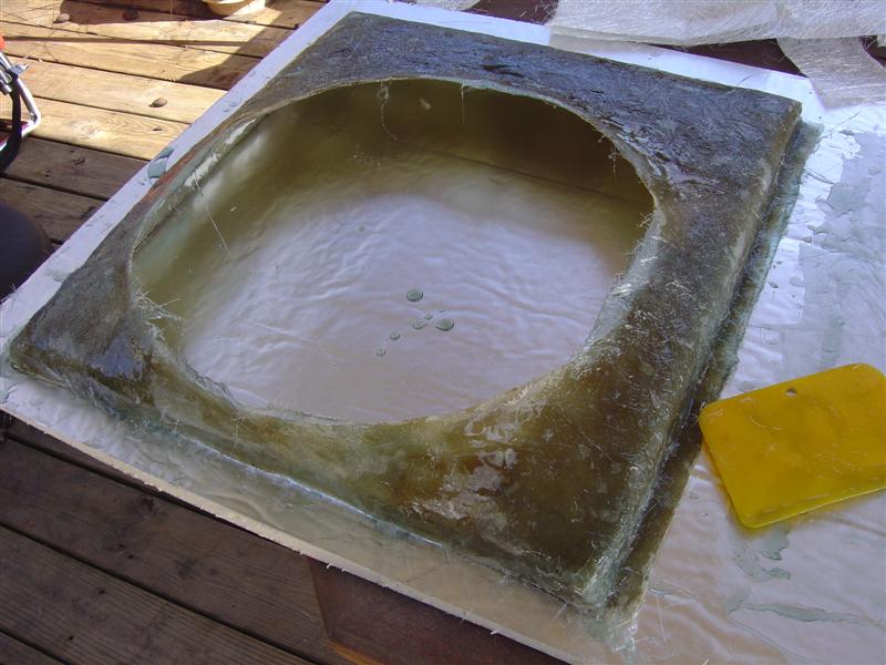

I was searching the net one day and came across directions on how to make a fiberglass fan shroud and figured it might help in keeping the temperatures down in my TR6 while crusing around town, and while I was off today waiting for the UPS man to show up with my new Boot lid I poped one out

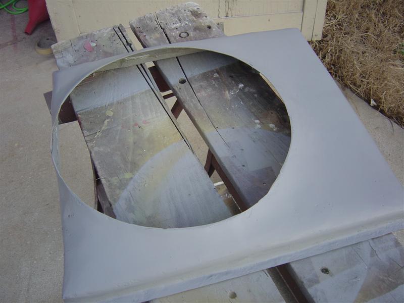

and primed, I hope it fits but I took some good measurements and I will have to take the radiator loose to put it in, and once I get the car painted and back on the road I will know if it helps this summer. got a few imperfections to fill before I paint it flat black

Hey Wayne, well my old bonnet had a lot of waves in it and since I had to take it back down to bare metal again, I saw one on ebay and said what the heck, so I got it yesterday, got it primed, only 2 small dings on it.
And DR thanks for the word on the motor mounts maybe I will order a new set and change them out first, but I plan on drilling slots for the mount holes on the shroud, that way I can slide it up and down to adjust for rubbing, the fan is 12 inch dia and the hole is 13 inches, I can enlarge is a little if need be

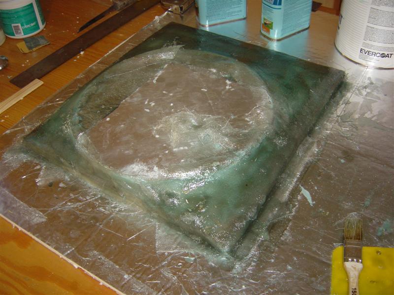

I made one from polyisocyanrate foam I purchased at lowes, anything else the resin will melt it. 2 layers of foam 2-13 inch diameter circles on top of that and some bondo to form the transitions. sprayed it with Pam nonstick spray and did the lay up.
