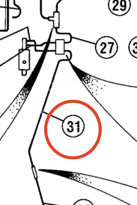

Howdy all. I've got a brake line question for everyone. Any advice on how to install a replacement for the line that runs from the PDWA to the rear of the car on a TR6? The front part of the line (which runs from the PDWA to a union about half way to the back of the car) was in bad shape.
I'm making a new one, but it's a tight fit down to the frame, and then through a frame bracket together with the fuel line and an emissions line. Any tricks of the trade - or horror stories learnt through experience - would be most welcome.

You should be able to use the exisitng tube as a bend template. If not, when I have something that is a tricky bend job and i have no exisitng template to work from I use a similar length of as close to the same OD thin wall copper tubing as the steel tubing and hand bend a template tube. I don't really worry about ovality or minor wrinkling at the bends, but do try not to make a hard kink at the bend. You can use wooden dowels to help determine bend radius from the old tube and make sure of the tube directional clocking (yes, I have bent tubes in the wrong clocking and said baaaaad things when ever that was done). My guess is the the bend radii is probably going to be 3 d (range of ~ .53 to ~.62" or if a bit of an outlier at 4 d (range of ~.72" to ~.81"). Nominal 1/8" ID copper tubing has an OD close enough to -3 (i.e. 3/16" OD) hydraulic line tubing to make for a well scaled bend template.
