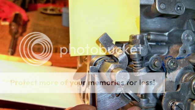

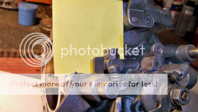

In this series of photographs you can see the throttle stop with a yellow background.
IDLE POSITION
HALF THROTTLE (shows up good)
FULL THROTTLE (within a hair of WOT, my grip loosened)
Notice the throttle stop just about touching the cast WOT stop projection and the actual throttle disc almost perpendicular to the throat of the carb.. If my grip had not loosened as I snapped the picture it would have been at WOT
