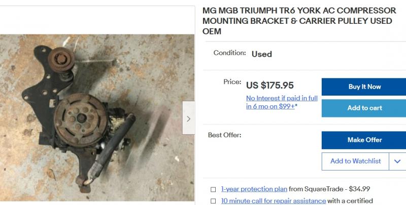

Unfortunately only a couple places make them and only one is like the original and they won't sell the bracket separately. Don't exactly want to spend $1400 for a kit i can only use the bracket out of.

steveg
This is currently on eBay:
https://ebay.us/mLQClc
