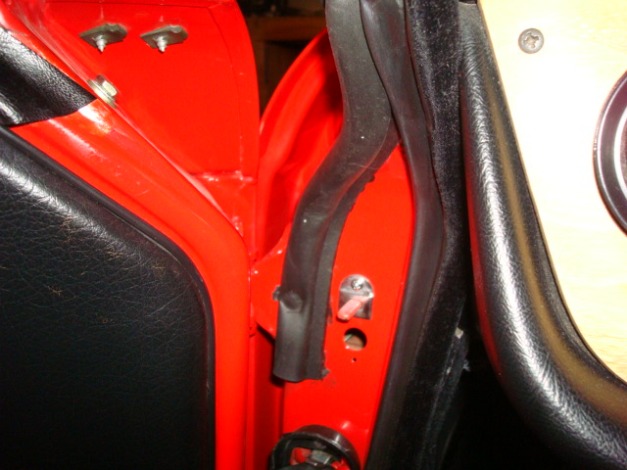

This may help, my camera battery died with this picture so let me know if you need more. TRF has two sizes one large and one small. Mine is the large, it seals very well. I believe it is larger than the original style. As for the length I'm not sure. Mine looks to be a bit to long. You can see the dent in the seal from the hinge bolt. Black weatherstrip seal work great.
Whoa... big difference in thickness. He will get the large ones from TRF.
I think the reason some get the small is that the large can make the door harder to close. That's what happened when I put new door seals on the TR4 but they soon took a 'set' and now the door closes and seals like a refrigerator.

MacGreagor in Canada sells seals that are supposed to be a perfect fit. I just ordered Bristleflex from him and he was telling me about that seal you're asking about.
Here's mine at the top and bottom without the bristleflex installed yet. You can also see my new door panel and door cap that I made out of leather.
