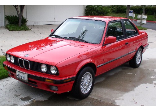

Oh yea! The 318 is great little car. We havent put many miles on it yet. I bought it real cheap, it needs a few little things, but We absolutly love it. tight, peppy,fun, good "old german car"smell, I've got it packed away for the salt season. I can't wait till spring.

I think you'll really enjoy the 318is. Not sure what sort of shape she is in, but make sure all of her steering and transmission mounts are OK. I had to refresh a couple of mine and boy did it make a difference. I'm sure you already found all of this, but evidential they are pretty engine chip friendly as well.
