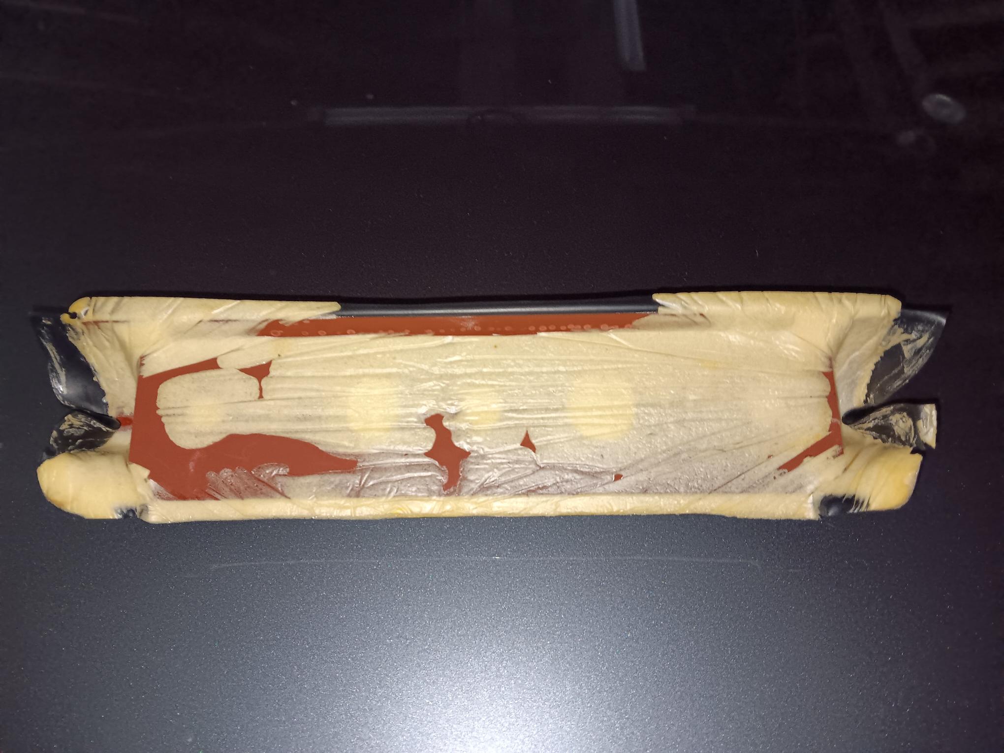

After some reading on the internet and poking around under the dash shows there is a bracket on the RH side of the plinth which bolts to the dash. I think unbolting that with the other items in my post immediately above will allow the plinth to be carefully extracted.
Interestingly, the new one is lacking that bracket. See photo. Not sure how much that really matters.
Bob
