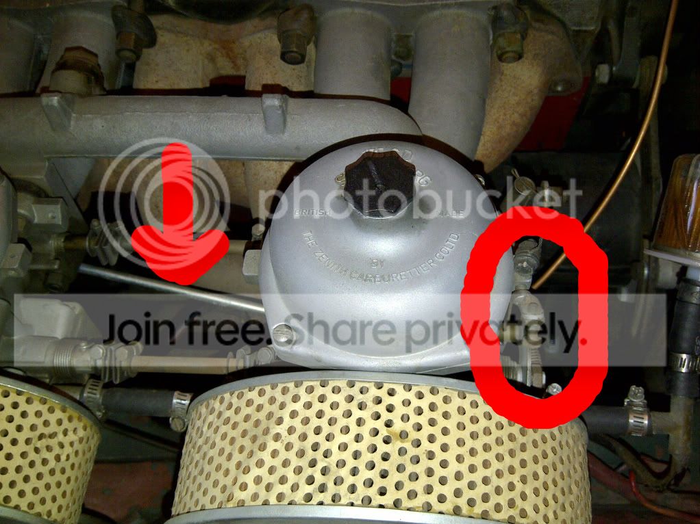

On my ZS carb the linkage with the arrow (which is a long single metal piece) pulls on the single carb lever circled to move both openings.

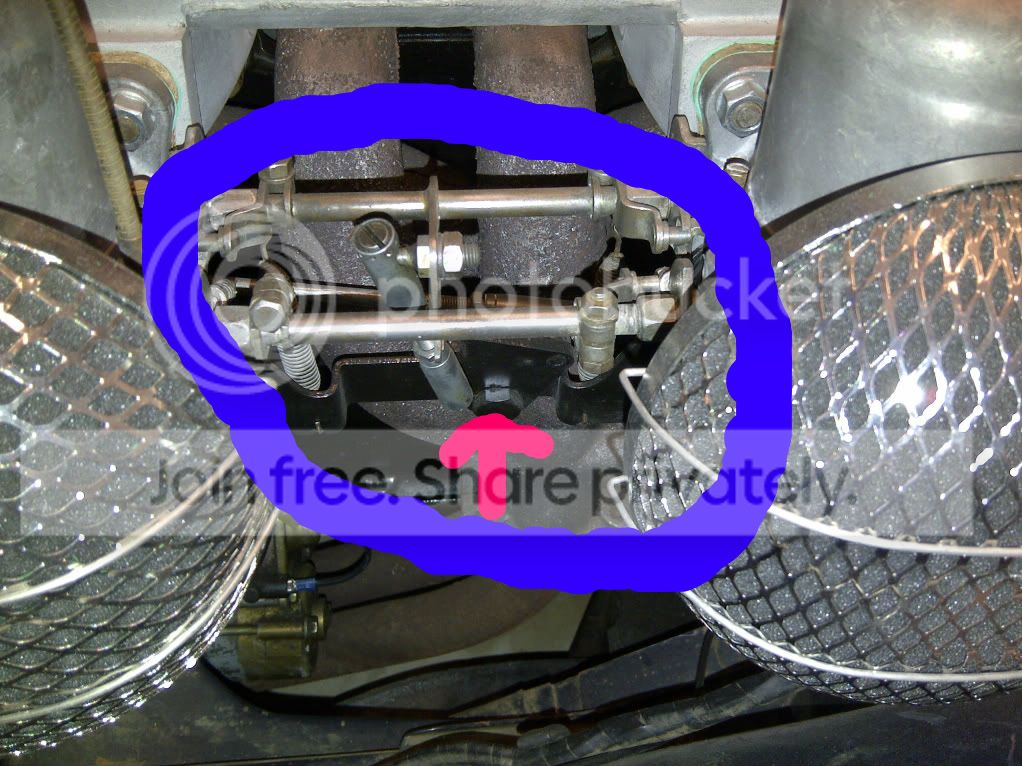

On the 4A with SU there is a totally different throttle to carb linkage assembly. This one is a center pull. The red arrow points to the black center assembly, everything is contained in the blue circle.
I am looking for everything in the blue circle, not the carbs or headers or manifold. Sorry for not being more clear up front.
Thanks!
Skip, now we have it, sorry for not understanding. Don't think he will be willing to break up the set. If it will help, the plate on the TR6 will work if you reverse the triangle to the other side and then shorten your rod to the accelerator shaft. Going on a bad memory here, been about 20 years since doing this on a TR4, and we were putting on a pair of 2 inch SU's off a Volvo. A couple of hooks to fit the SU throttle shaft (MGB) and you are almost there.
