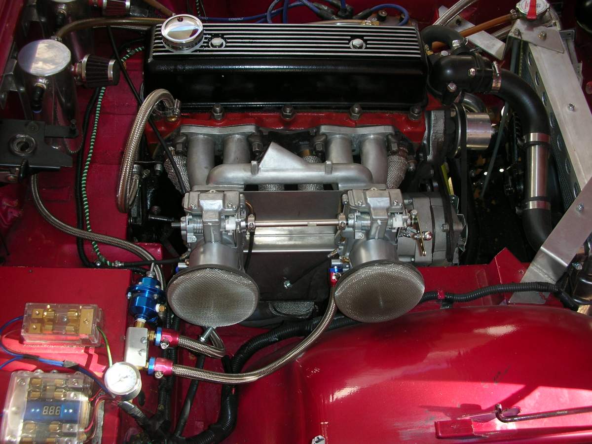

jimg
Modern Day Technology ? I have some of that
I use the 1-2-3 programmable distributor and it works great.
I can dial in a timing curve for any track or altitude.
( I live at 5200') We run 36 - 38 degrees advance up here.
I also use the Mikuni HSR 45 carbs which were designed as a direct replacement for the SU's. They flow the same as Weber 45 DCOE's but you can dial in the jetting in an afternoon.
After that just forget about em. They never screw up.
Also, 1/2 the price of webers.
Another bonus is I can have a carb off the car and in my hand in just over one minute.
I use the MSD 7AL-2 ignition with the 1-2-3 distributor.

Can you post a pic of your set up, sounds interesting
I have some up my face book page.
Jim G
https://www.facebook.com/home.php?
try this
