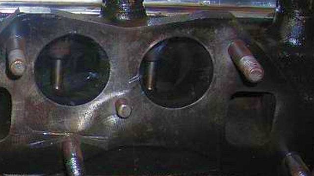

Hi guys - can you please confirm that this is a standard late TR4A head set-up? Looks like it to me but would appreciate confirmation.

1) Cylinder Head itself: I honestly don't know the differences in cylinder heads to say.
2) Exhaust Manifold: from what little I see from the picture, it looks correct. It should have two (not one) exit port.
3) Intake Manifold: it looks to be the correct one.
Now, to answer a question with a question. Your exhaust manifold appears to have been treated or refinished in some way. Any ideas what? Mine is still the stock one but very rusty. I would like to find a way to refinish it without having to remove it (call me lazy).

Hi Bob - I used the Eastwood manifold dressing. A bit messy to apply but it looks much better than what was there. I need to touch it up on this side still.
We'll see how it handles the heat.

It's tough to be certain from that photo, but I think that is an earlier head.
It should fit and work fine, but I don't see the flat above the #1 exhaust, and I think I can see (by tweaking the photo a bit) the marks where the intake ports were milled out after the head was cast.

I think you meant the flat above the #1 intake according to TeriAnn's webpage on heads.
Gee, uh, you mean the big hole is the intake and the little hole is the exhaust ?
