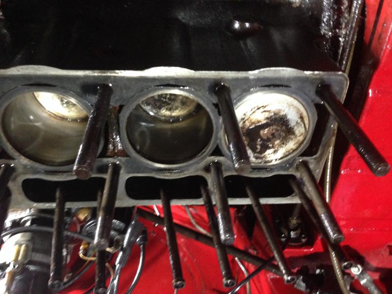

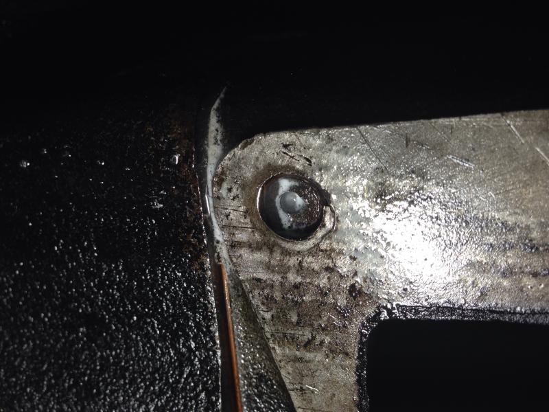

During a removal of the TR4A exhaust manifold the lower rear stud twisted off in the head.
I drilled the stud out but the easy out just smeared the and nothing came out but shavings.
All of the other studs came out with some lots of WD40 and double nutting.
From the PO this car had a history of blowing out the manifold gasket every 30k-40k miles right next to the broken stud. I am in the middle of the first pass at a mechanical restoration of this vehicle which has not run since 84. The vehicle has 144k miles total and had a lower engine overhaul around 85k miles.
The had a broken valve spring around 50k miles other then that no other mods since new in 67.
This has original valve seats and valves (not modern hardened for unleaded ops).
I have removed the head and handed it over to a machinist who is evaluating the broken stud.
I have not looked at the cam shaft
After the stud issue is resolved we plan fo fit check of the manifolds (without gasket) to see if we need to do some "adjusting" of the rear manifold port.
I plan to replace the manifold gasket with the Moss uprated gasket (695-070).

Stud can be EDM which would save the threads. After that I would have the machine shop skim the manifold surface on cylinder head. I would also have the exhaust manifold done as well. As far as performance up grades go as far as your pocket book can handle and enjoy the car.

It was the exh manifold gasket that blew out every 30-40k miles...
It blew out toward the car bulkhead from the rearmost cylinder of the engine...
The stud that just twisted off was the lower rear stud... right where the gasket kept failing.
Guessing that the rear port of the exh manifold is not flat on the head...

Do whatever it takes to repair the threads in the head. With care, you may still be able to save the original threads; if not I would start by installing a Helicoil (or similar) insert. If that fails (I've never had one fail but others say they have), then try one of the larger solid inserts.
If the shop doesn't skim the sealing surface of the head (which requires removing all of the studs and the two locating pins), then you can do the equivalent yourself with care and a fine tooth flat "machinists" file. I almost always find that the surface is pulled up around the stud holes. Do the same for the manifold. Actually, from the amount of damage I see in your photo, I'd ask the shop to skim the head even if they don't think it is necessary.
When you reinstall the manifolds, be sure to leave loose the connections between them until after everything is fully clamped down. I actually just leave the connections permanently loose, as that extra heat to the intake manifold can't be helping performance in warm weather. Also make certain the intake fits over the locating pins before you start tightening the nuts. Pulling it into place with the nuts can turn up a burr inside the hole that keeps the manifold from fitting snugly against the head.
On the front & rear studs (the ones without the bridge pieces), I find it works better to add a heavy "setup" flat washer between the manifold and lock washer. Obviously, replace the lock washers every time as the heat causes them to lose their spring. And recheck them for tightness from time to time, weekly at first until they stay tight then less often. For my money, the tall steel nuts work best. Use some anti-seize on the studs (I like the copper kind).
There are special extra-thick (and heat resistant) gaskets available, but I've never had to use them.

Manifold stud hole was repaired.
Had hardened exhaust valve seats done at the same time...
