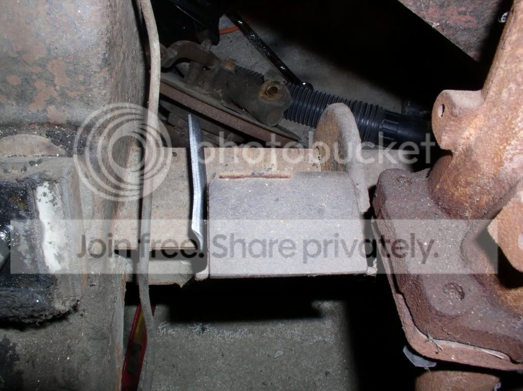

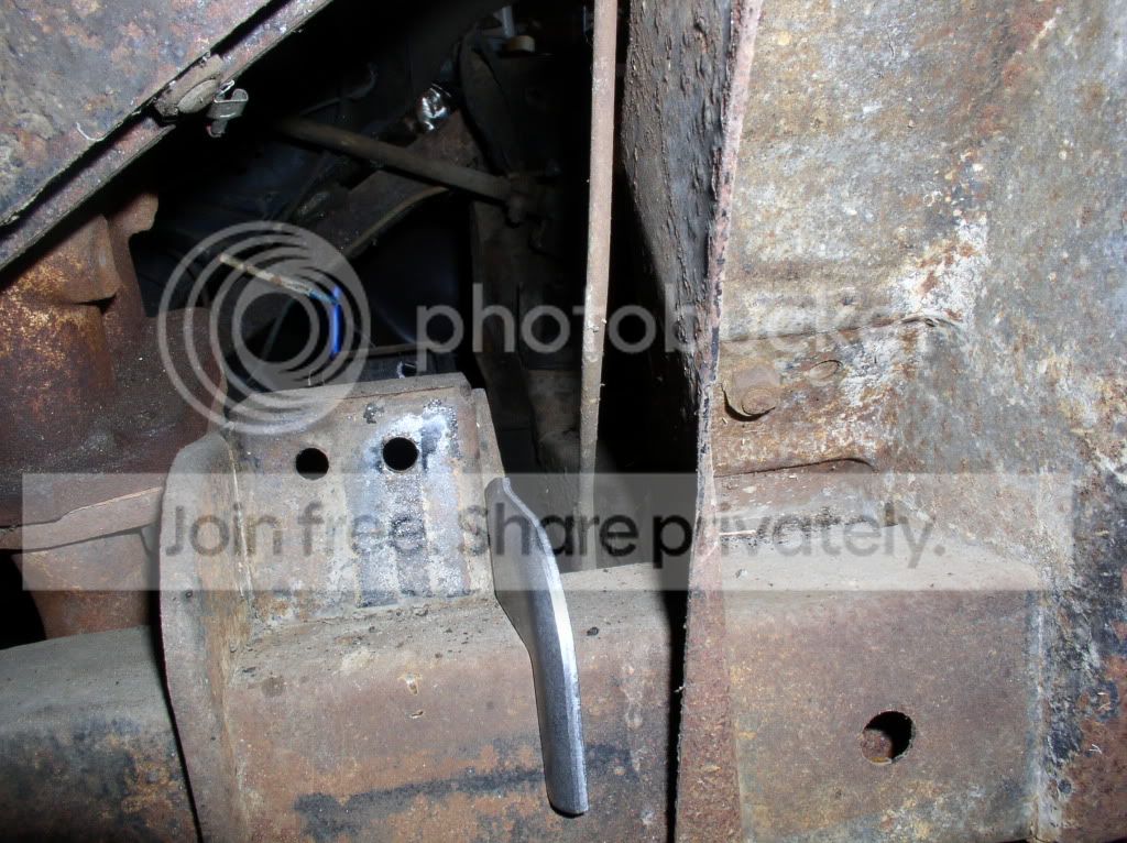

TR4/4A TR4a gussets go like this?
tdskip
Looks right for a TR4A?
Should put some extra strength to it. Have repaired several in the past few years. Have and early 6 that needs it now. Someone really butchered it up.

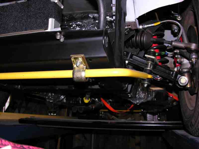

I'll take photos for you Sunday of the gussets and my Addco TR6 (7/8") front bar on my TR4A. The bar is mounted on a TR6 radiator guard.
The outer holes on the TR6 radiator guard are for the OEM sway mounting. The spacing on the addco brackets is wider and I had to make a new set. The bar is a 7/8" thick Addco bar made for TR6.
I checked my inner fulcrum bracket gussets and yours are placed the same. I'd have a photo for you but as you see, my frame is wrapped in plastic to protect it from the unfinished tub,

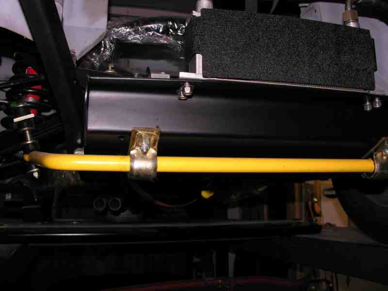

Another view of the Addco:

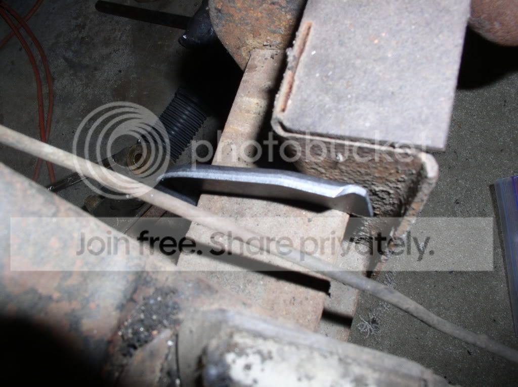

I would also suggest adding some weld along the top box edge on your brackets to give them strength (as seen in your photo #2.)
-PK
<span style="font-weight: bold">Good point!</span> I missed that Peter.
