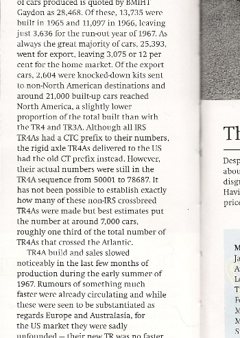

Just to clarify in my head, any solid axle TR4a will will only have CT (instead of CTC)for the commission number? I do remember reading that the extra "C" meant that the car was IRS but also had it in my head that all TR4As were CTC.
Marv
"...any solid axle TR4a will will only have CT (instead of CTC) for the commission number? <span style="color: #FF0000"><span style="font-weight: bold">Yes!</span></span> I do remember reading that the extra "C" meant that the car was IRS <span style="color: #FF0000"><span style="font-weight: bold">Yes!</span></span> but also had it in my head that all TR4As were CTC <span style="color: #FF0000"><span style="font-weight: bold">No!</span></span>."
From Triumph TR by Piggott.
