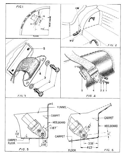

I upgraded to the 3-point seat belts from Moss. According to the parts manual, Triumph offered a 3-point kit (#568946). Does anyone know if that kit provided directions regarding the appropriate mounting point on the wheel well? I do not want to reinvent the wheel if I do not have to and any assistance would be greatly appreciated.

Place the attaching point as high as you poss can on the wheel welland back it by a large thick washer.
You want it as high as poss so that if needed, we hope not, it will not compress your spine. Low mounted pivots cause spinal injuries as they not only pull back but down. That's why all modern cars have a very high mounting.
This was prepared for TR-2, 3, 3A but may be helpful:
