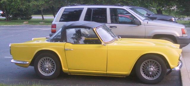

Mike, I JUST bought Continental 185/65R15's. I have wires, plus I drive my car A LOT on the street. The profile is a bit lower, but they're a little wider than the metric sizes. ...plus they were very reasonable. Let me attach a picture of what the ride height looks like....
What size (width) rims are those wire wheels. My tire guy told me he could not fit that size tire on my 60 spoke wires since they were only 4.5 inches wide. I would love to be able to go with that size tire just for ease of purchase and cost (especilay for my spare - though it is only a 4 inch 48 spoke wheel).
If you have the 4.5 inch rims, con you tell me how long you have driven with that size tire (or any one else who has fit a more easy to find tire on a 4.5 inch rim)

I have 4.5" rims........and i've been running these 185's for about 2 months now. Prior to that, I put about 35,000 miles on my old 185's. (I replaced them due to age...even though I drive the heck out of this thing)
