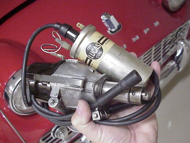

But then, where ignition is concerned, on long trips I simply carry one of everything:
I don't carry a coil, but the rest of the system, including known good plugs. It fits easily inside the spare. A backup is the next best thing to redundancy. Two nuts, and the whole system can be swapped out. Maybe the side of the road timing could be better, but in the case of complete failure, my guess is I can make it all the way home on the 'spare' with points.
