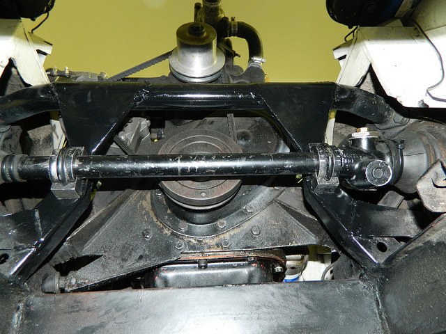

The Works TR4 Rally thought so. I received a list including pictures of modifications from Ian Cornish for rallying a TR4.
About the steering:
Steering: the cars have the early rack, which was mounted on two brackets rising vertically (Arrow 5 on diagram). To prevent these breaking off, the cross tube (Arrow 6 on diagram), which connects the two turrets of the front spring mountings, has a pair of brackets facing vertically downwards so as to meet the upcoming brackets (this is very clear in one of the shots in “90s Photographs/4VC Rebuild”). The rack is solid-mounted (no rubber) and each of its U bolts pass through the rising and falling brackets where they overlap. This is very strong, but makes installation of the U brackets a little fiddly!
I built the reinforcements and put them on my car last year, it made the steering much more "solid". I am using larger tires.
Yes, I replaced the motor mount on the left of the picture.
