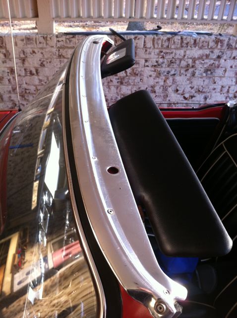

Here's a picture of my topcap.

Doug,
For the TR4, the windscreen cap should be the same and I only see 1 part number in the SPC. For the TR4A, you have to replace the windscreen capping with the TR4 one (806189).
Scott
Good to know, thanks. On the other side of the cap the button is missing. Is there anyway to repair that without taking the top cap off?
I've not seen the back of one, but if it isn't torn off and the hole is in decent shape I'd think you could carefully pop rivit a new button in place.
Randy,
Sounds right to me but then again both of mine are TR4A's which don't have that snap in soft-top form, but the rivet has to go into the windshield frame.
Scott
