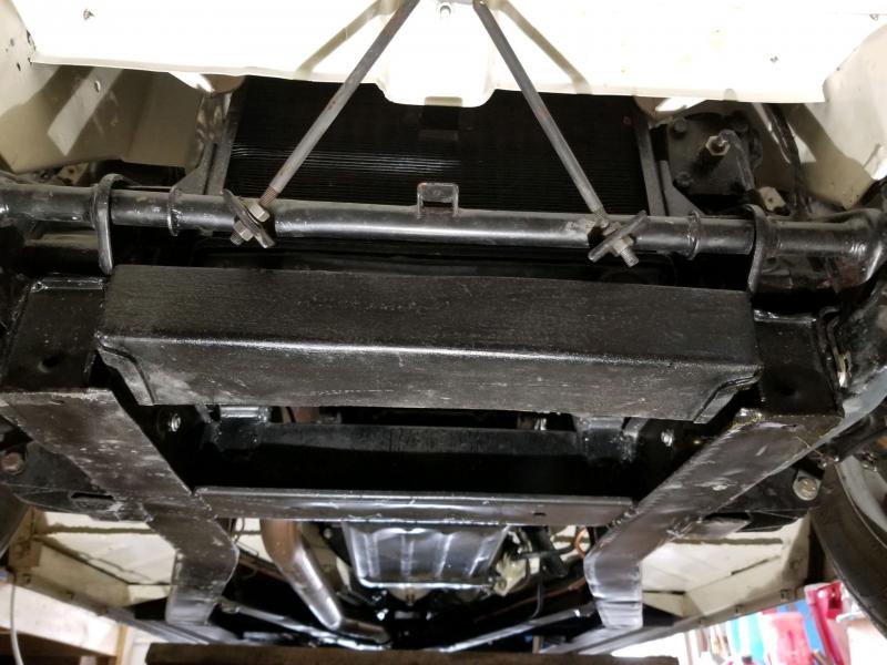

The TR3 radiator guard fits between the frame rails. There are 2 bolt holes each side for a long bolt with a nut. 3/8"I believe.
At least that was how my TR3 is set up.
David
