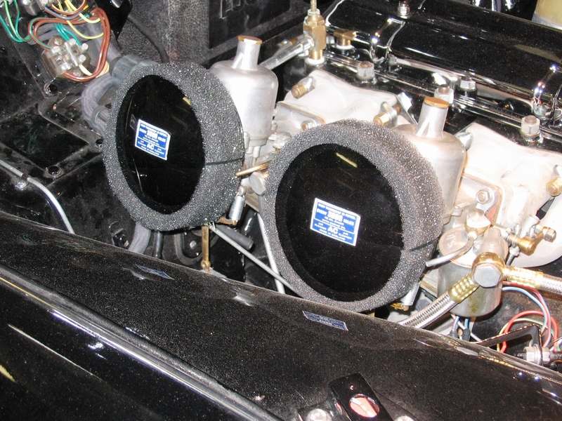

How old are the rubber hoses between the fuel pump and the carbs ? I suspect that the ethanol is swelling the insides and blocking the fuel flow. I had this about 10 times during 2007. I took the pump outlet pipe apart and had fuel flow. But none was pumping out the line up top. Also the float bowls were empty. After a while it would run again. Couldn't figure out why. It was Randall you wrote about the old rubber hoses.
I now add 4 oz of Marvel Mystery oil to each fill-up and I changed the feed hose on my early 1958 TR3A. I had a new hose made by a local hydraulic shop and have had no problems since. But I buy gas at Shell or ESSO - never again at Sunoco or Petro-Can. Where did you get your last tankful ? And I haven't been back to the USA since.
See my new hose at the lower right feeding the banjo fitting into the float bowl for Carb #1 and then contiuing to Carb #2 under the filter for Carb #1.

Don,
This happened on my TR4 and the only piece of rubber hose in that car's fuel system is a 3 inch length just before the fuel pump (I was worried about a hard line all the way to the engine in case the engine movement would be a problem). Other then that there are the little connectors at the carbs themselves but the hard line touched the carb input there. The rubber is four years old (which is when I finished the the TR4 restoration).
I like your fuel lines on the TR3 though. I might get some made for mine since it is apart. Did you supply him with the banjo fittings or was he able to source them?
