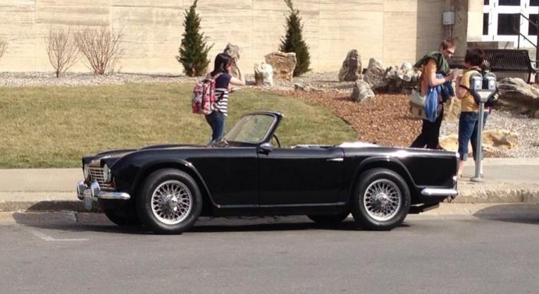

Scott, is that a "black" TR4? What shape is your paint job? Looks like you should show that car off a bit.
Thanks for the interest! Is that a black TR4 in your avatar, too?
Yes mine is black, courtesy of the PO. However, whoever he got to do the job was terrible. He admitted this himself. It looks fine from afar, but there's some cracking in places and you can see the previous (original?) red color underneath. The red peaks out in other less conspicuous places where it just wasn't painted (e.g. behind the fuel tank). It clearly wan't sanded and primed very well if at all before slapping the black paint on. But it's a good-looking driver, so I can't complain too much.
I will definitely show it off soon! I've been working on getting it in good road condition. I just pulled it out of the garage for the first time in 3 months, so it's almost ready! I'm about to go back out there and put the interior back together and take it for a spin to the gas station. I'll post something this weekend if all goes well!

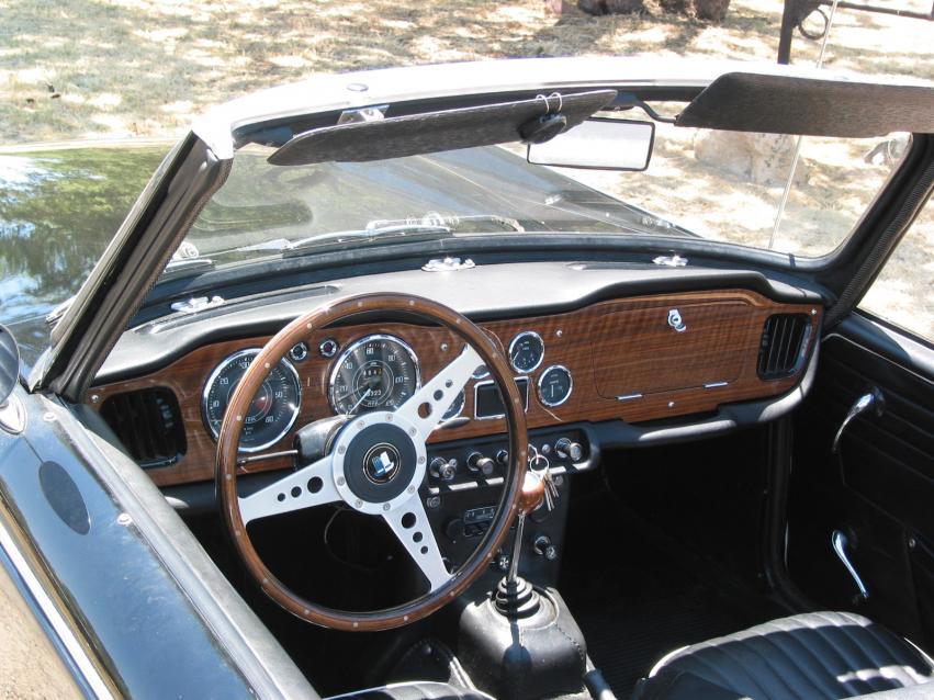

Yes, mine is black, too. It's a great color on a TR4. I'm not sure which of the prior owners (there were 3) on my car resprayed it. But the local shops always tell me that someone really knew what they were doing. It makes me want to learn more about paint and types of paint jobs just in case mine ever needs it again. I don't know if it's an acrylic or hand rubbed lacquer or whatever--but I do know that all paints and painters aren't alike. Take care of that car, and one day you might decide to do something about that cracking and the red peeking through. Shucks it's only money!! BTW, when I bought mine back in '04 I spent 6 months just redoing the front end bushings and springs, handling the tuning, alignment, POR15 for the frame, new wheels, new rear shocks and shock links, and stuff like that. I was lucky, and it all ran like a new car when I took it out on its first new ride. Later, I added a new fiddleback walnut dash from Randy Keller (Prestige) in Santa Ana. IMG_1807.jpg
Thanks for the words of encouragement. That dash does look good! As does the rest of the interior as far as I can tell. Mine needs a little work, but I'll get there eventually!
