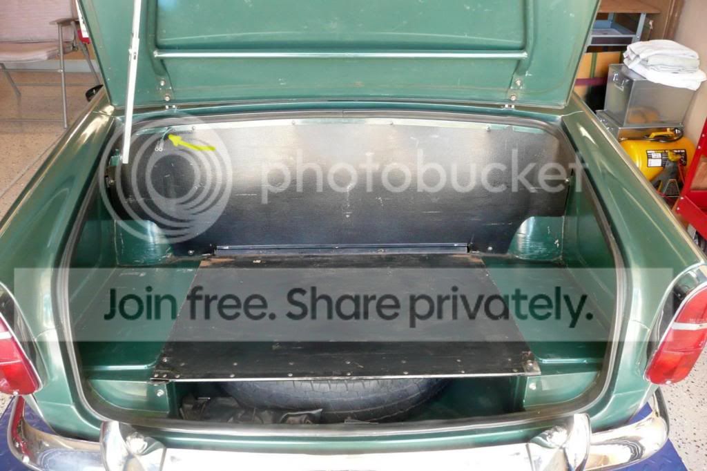

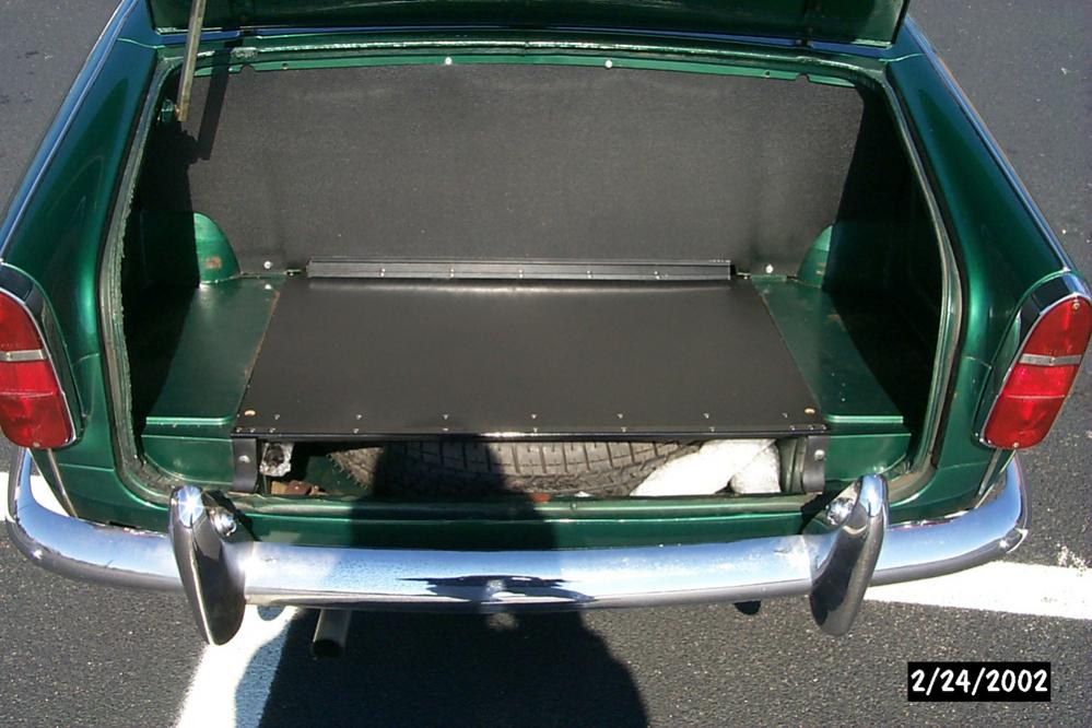

I have a couple of questions about the boot area of the TR4. I found a picture on the internet that shows the boot pretty well, this is NOT my car.
The board that covers the gas tank, I have a new one, there was not one on my car when I purchased it. In this picture the top of the board is on the back, or the gas tank side of the metal lip. Is this correct?? I had planned on placing the board in front of this lip.
The other problem I have is the new Trunk seal I ordered from Moss. My trunk had no seal when it was purchased. with the seal installed there is no way to get the trunk to latch. It is just too thick. I see in this picture that the seal has been trimmed so that it does not run along the bottom. My trunk would probably close if I did that. Is this correct?? Or is there some other solution.

You want the lip behind the board that covers the tank area. When you open the trunk/boot you have the option of lifting the 'floor' board before you lower the boot and you can let the rear (now top) edge of the floor board slip behind that horizontal brace on the inside of the boot lid. You can then finish lowering the lid to the latched position and it will hole the board in the 'upright & locked position'. Hard to explain but try it and you'll see.

Here's a shot of my boot. The is a long notch along the bottom of the board that covers the tank -- that notch captures the lip on the back edge of the floorboard:
From this angle you get a better look at the notch which is edged with metal:
Here you can see how the cross brace can be used to hold the floor board up while you drag out the spare etc:
Awesome! Thanks for the pictures. I see how everything goes together now... Project number 2 for tomorrow! Assemble the boot...
