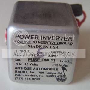

Here is something else for the average TR enthusiast who may not want to delve into component level electronics.
https://www.mgaguru.com/mgtech/electric/et207.htm
and this: https://www.powerstream.com/dc24.htm
