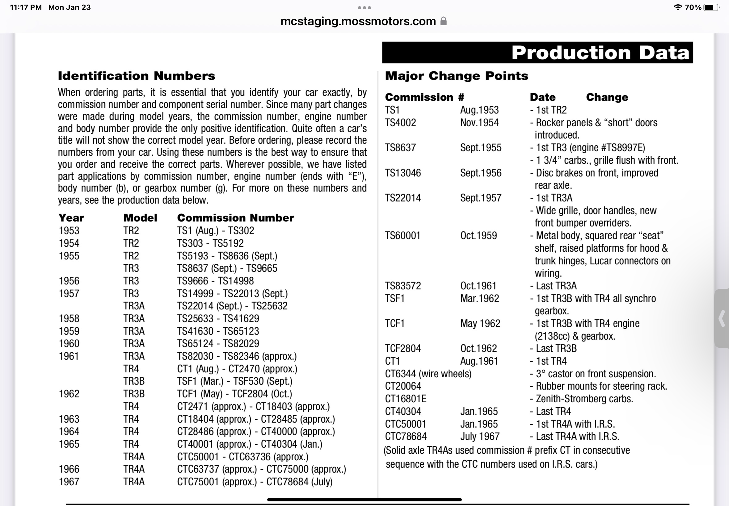

Moss lists CTC 70414L as a 1966.
Moss lists the following year for each TR4A Commission Number range:
1965: CTC50001 - CTC63736 (approx.)
1966: CTC63737 (approx.) - CTC75000 (approx.)
1967: CTC75001 Approx.) - CTC78684 (July)

From our friends at MOSS Motors:
