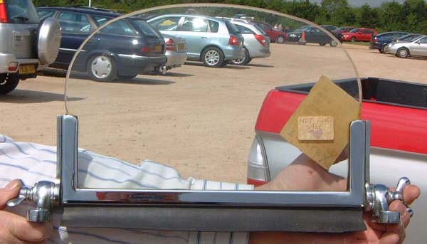

Back in the 50s, many TR2, TR3 and TR3A owners would drive to the track on race weekend, remove the spare tire, empty the trunk, remove the hub-caps and the windscreen (4 quick Dzuz 1/4 turn fasteners and drive the race with their aeroscreens on (well maybe at least one).
This only applied to the original S-T aeroscreens which were attached with two chromed hex-bolts up on the top of the skuttle.
This could not work, would not work and will not work with Brookland aeroscreens which require 4 sheet-matal screws to hold them on and the Brooklands cannot be used along with the full windscreen.
Notice that the glass is much larger and that the original S-T aeroscreens came with a rubber strip along the bottom (like on the full windscreen) to keep the rain and wind from hitting you in the face as the Brooklands do.
Tom Maddox in England has developed new repro S-T aeroscreens which can be used as they were intended.

So Don, if I understand correctly the answer is:
With Brooklands = no.
With T-R aeroscreens = yes.
Perfect!

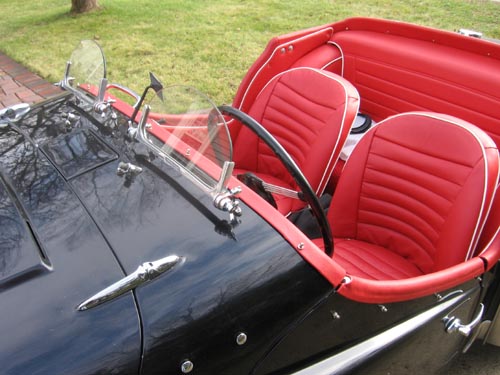

Hey Bruce, Here is a couple of shots of my windshields.
It might fit with the big windshield on, but it will be a tight fit!
I have done the switch from Brooklands back to the big windshield a few times for the different looks. The four chrome bolts go into caged nuts under the dash. So you don't have to do the twist up under there. I did not use the mounts supplied with the Brooklands but got the different "feet" that you see in the photo.
I had a ebay set of repro aeroscreens on my last 3 (not as tall as the ones in Don's photo) - mine was a 3A and the holes I drilled were far enough back to have them mounted with the windshield. However, I never ran with both mounted because I found mounting and un-mounting the windshield to be a pain for one person and ran the high risk of scratching the skuttle.
Incidentally though, I used the black plastic plugs designed for holding interior panal in for modern cars to cover the winshield mounting holes - was there ever a purpose designed part for this or were they left open?
Cheers,
Kerry
You can run the Brooklands aeros with the full windscreen. A guy in our club does it. All you have to do is get the mounting brackets located correctly. Once they are on, you never have to take them off, as there are set screws that hold the areos onto the brackets. Loosen those, and the aeros just slide out of the brackets. That arrangement however, seems to put the aeros too close to the steering wheel, so I wait until the windscreen is off, and then mount the areos into the brackets from the front.
