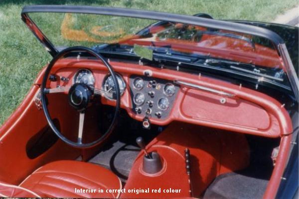

When I bought my 1958 TR3A brand new in May, 1958, it came with rubber floor mats for the front footwells. There was some canvas about 6" wide glued to the bottom side. The mats were black rubber and went up the firewall about 10". There was some beige (fawn) jute underlay about 1/4" thick. There were black painted snaps to hold them down to the floor panels.
In 1990, when I was finishing my restoration, some repro mats became available so I bought some in England. The snaps were about 1" out of place so I figured out where the bases should be located to hold the new repro mats down correctly onto my new floor panels. Also these snaps on the repro mats were left bare brass, so I painted thm black to be as the original ones.
Here is my interior in 1990 with the new repro mats.
