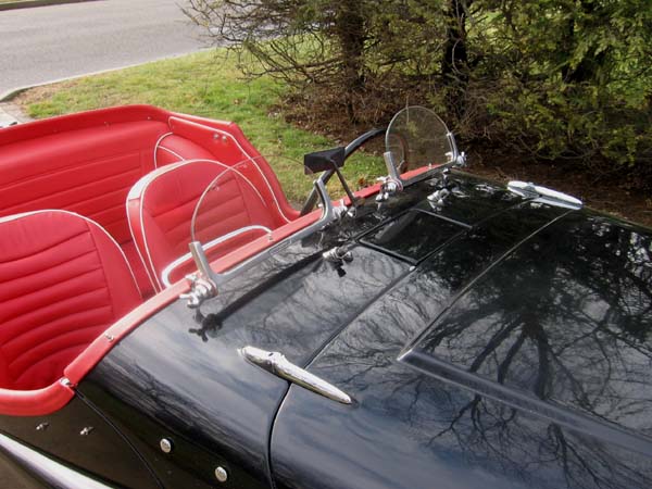

Thanks for the info guys. Anyone have an opinion on Brooklands Racing screens? They look great on the TR3 and lowers the car's profile but I wonder about the practicality of having them on. Might be like riding a motorcycle in terms of wind in your face? If a person only drives on sunny days and isn't going on long trips then I suppose weather conditions aren't an issue. And you can run racing screens as well as the windshield if mounted correctly. I have an opportunity to get a set at a good price but was wondering if anyone has a set mounted and what their thoughts are.
I have a set of aero screens that I use from time to time. Truth be told, the Brooklands screens aren't that much lower the the full screen. If you install the brackets in the right place, you can leave them in place with the full windscreen on. Just remove the full windscreen and slide on the aeros. When using them, I also don a set of Halcyon goggles which are manufactured by the same company that supplied the RAF pilots in WWII.
Edit: Here's a pic of me and my buddy Dave on the TR3's maiden voyage after the resto was complete. :laugh:
