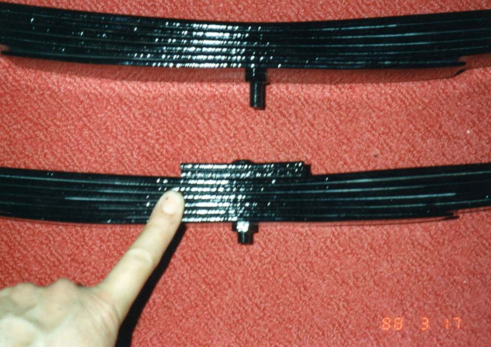

I have a spacer on the rear spring for the RHS. It was reputed to compensate for the camber in the road where there is a crown. I also heart that it was because a driver is always in the car but the passenger's seat on the RHS in No. America is often vacant. That was rarely my case !
