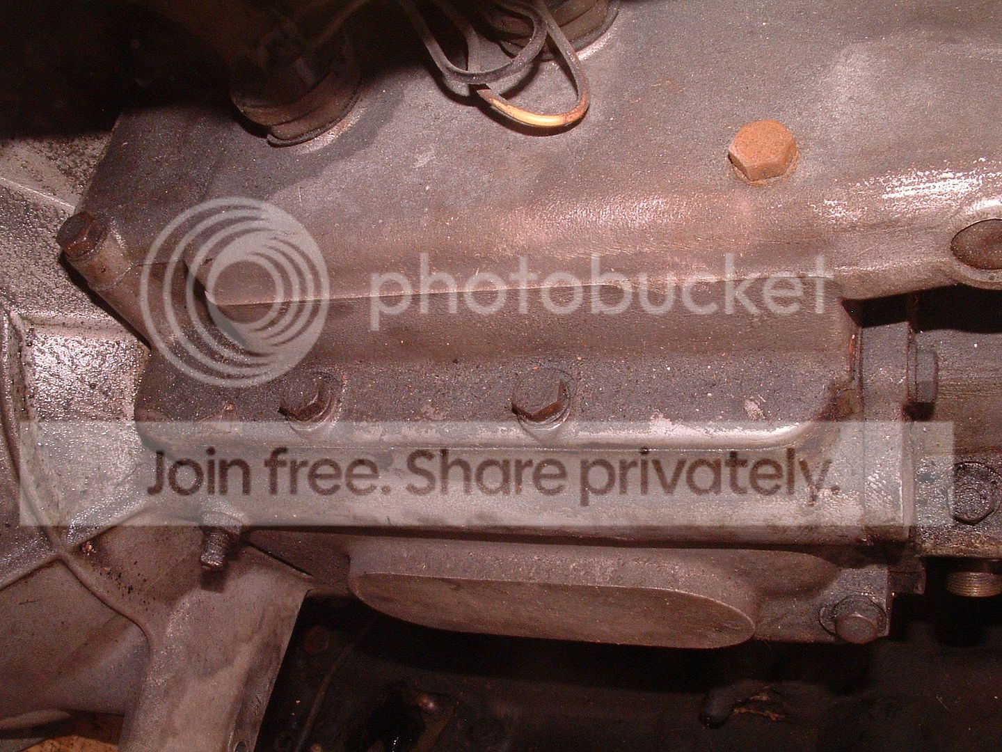

Here is a shot that shows (barely) the head of the set screw. You can see the speedo drive sticking out below it.

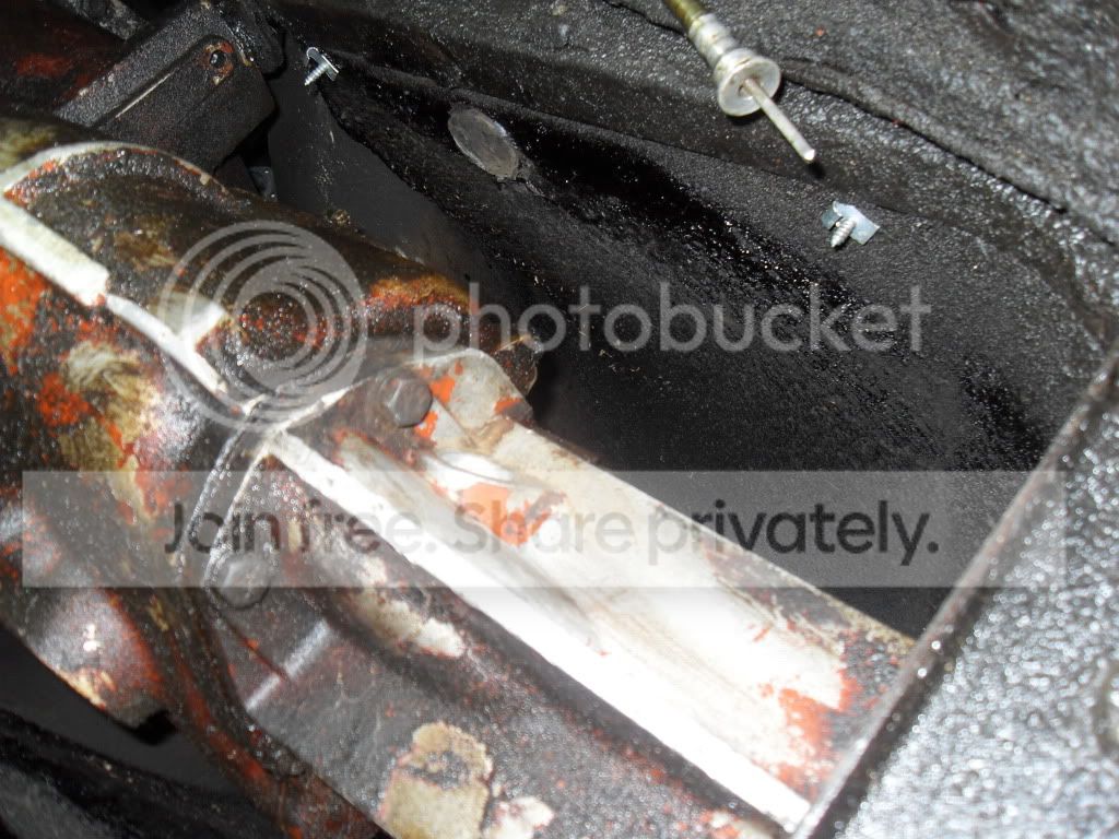

I don't see any setscrew like the one you show but I will have to look at the car later. I assume that the screw hole will be perpendicular to the drive gear shaft, and it's purpose is just to ensure that the assembly doesn't come loose.

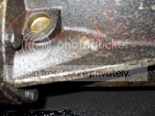

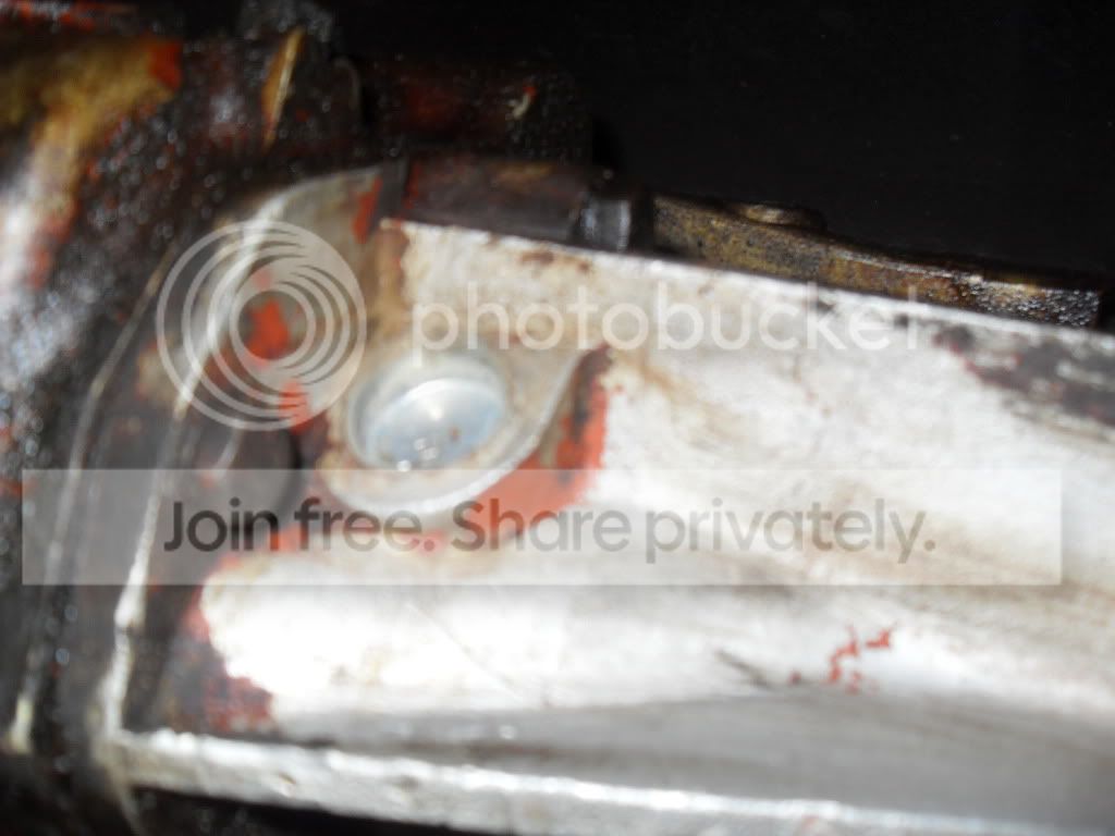

Ok I crawled back under today and took a few more pics after cleaning up a bit. There is no sign of any set screw and as I look at what is a thin metal cap I wonder how I'm gonna get this sucker out. There isn't any lip that I can see.

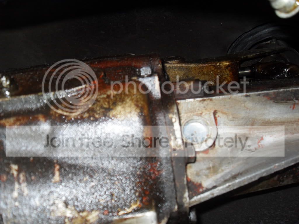

Here is another.
The second is a pic of a club members 3a tailhousing. it looks very similar to mine but he has an O.D.
Hard to really tell anything from those shots, as the hole for the setscrew would be on the other side of the protrusion above the hole with the plug.
To remove that type of plug normally involves destroying it. One way is to drive a screwdriver or punch through and pry it out; or I have seen purpose-made pullers that use a big screw through the center of the plug. If you Google for "Freeze plug removal", you'll find lots of suggestions.
BTW, not sure if the wrong photo got posted or what, but that second shot is NOT of an overdrive. The body of the overdrive replaces the entire rear housing of the non-OD transmission; that is clearly the non-OD housing. The OD sticks out beyond the body of the gearbox, that location would be covered by the solenoid bracket/accumulator cover. As I mentioned before, with OD the speedo drive moves to the other side (and back about a foot to the output of the OD).
