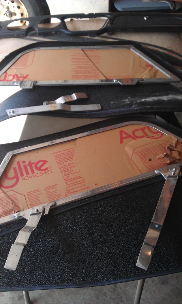

do these look familiar. they were purchased in early 70's from JC Whitney catalog. IMAG0100.jpg
Those sure look like mine, altho' mine have LTD fasteners along the bottom edge. By the way, here's what I learned from Tom Clarke of Clarke Spares:

Those look exactly like mine too ... including the protective paper. Will take more pics if anyone is interested when I get home later this week. Cheers, Mike
