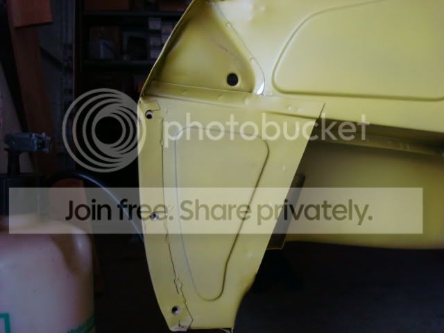

Check out this pic please. I think this is Mallard (Keiths) Car.
Is this part number 800639/40 on this TRF catalogue?
https://www.zeni.net/trf/miniTR2TR3/31.php
Also, can anyone tell me if this part has the 3 cage nuts welded on the inside for the rear fender mounts?
I think that I might need to replace mine as there are so many pop rivets in there and metal over top of metal it is a real mess......
Cheers,
M. Pied Lourd

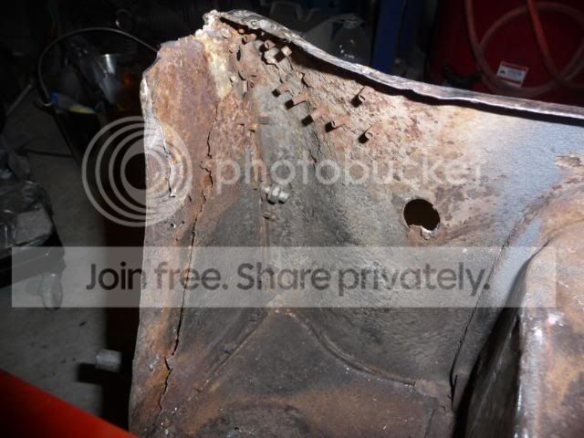

Oh, Here is what mine looks like on the inside.
The cage nuts have all rusted off and you can see that the PO was just using regular bolts/nuts.....this explains the sheet metal screw attached access panel where the welded closing panel should have been.
Cheers,
M. Pied Lourd
panel, end stiffenig RH 800640 LH 800639 Cage nuts are included. PM me if you need the left side. I have one TRF replacement for the left side. The reason I did not use the TRF panel is because the stamping is not the same. The replacement has an oval raised area instead of the triangle shape as original on the early cars.
