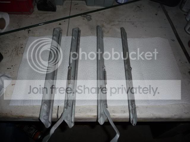

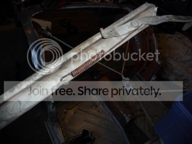

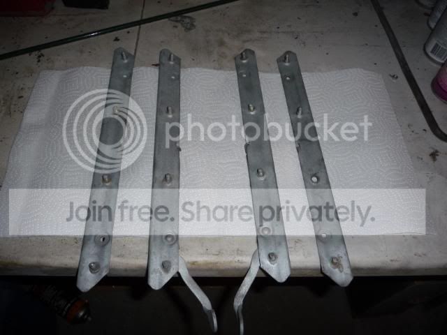

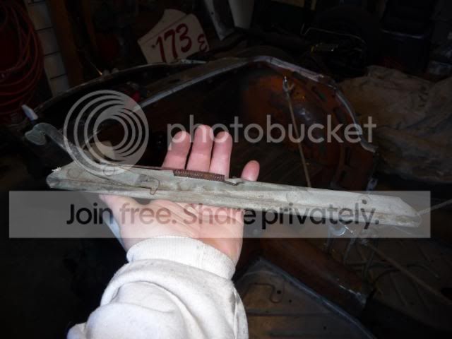

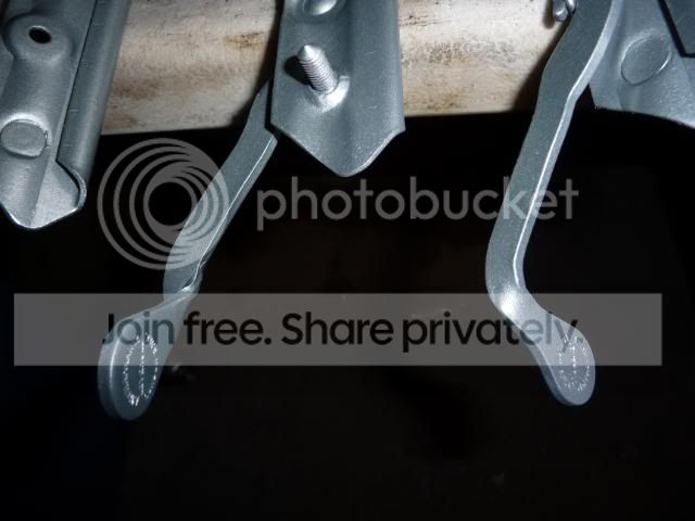

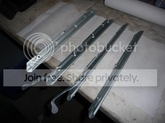

Hi Guys,
Just a quick update with some photos. Did some of the bits for the seat tracks with the Silver Cad from Eastwood. ( I still need to get the bottom tracks off the old floors that I took out of the car, they were rusted to the cage nuts solidly)
As they came off the car
After Media Blasting
After the Silver Cad.
Not sure what they are supposed to look like...all I know is that they look alot better than they did....

Hi John,
Thanks, just a couple of coats of self etching primer followed by three coats of the silver cad. I suppose you could clear coat them as well...

Hi Scott,
Actually, pretty close to my 6 seat tracks...you can see some of the shine under the rear seat lock/keeper plate.
My 6 had no carpet in it when I bought it.....seat tracks were painted when I did the resto on the 6.
Definately looks different from Silver or Aluminum paint. The silver cas has a bit of a blue tinge to it.....reflects the light a little differently.
