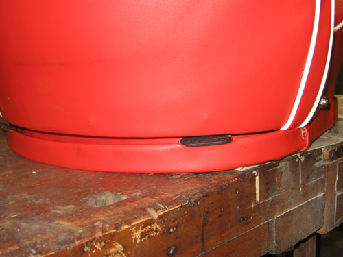

Oh ya one more question. Is the edge of the seat pan supposed to be covered with vinyl too?
Yes...
Everything your guy needs to know about seats is in Craig's pdf file (including patterns) BCF

Thanks! That settles that. The pic is a great help. I droped them off today and told him to cover the pans too. Man is he cheep. $250 that includes material and labor.
