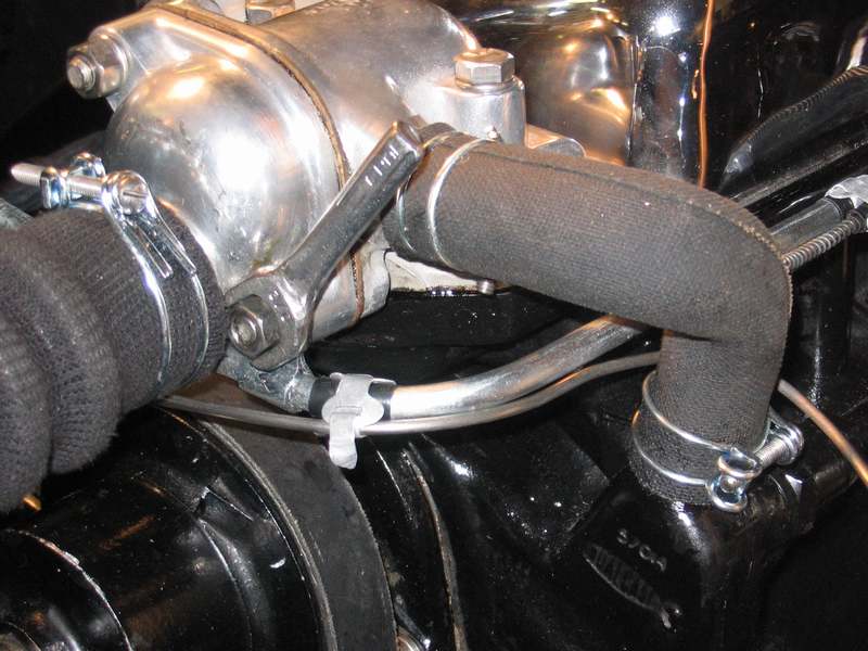

Well, after a bit of a break from working on my 39 TR3A, I'm starting to regain my mojo and want to get back to the garage and visit my British girl. With newly rebuilt engine (yes, and leaky modern rear seal - S%#T!), I am also having coolant leaks. I purchased a hose kit from a major vendor but the large radiator hoses (Taiwan manufacture) appear to be too large in diameter and don't seal well at all with hose clamps. I have leaks at the water pump/hose connection and at the radiator coupling to lower hose. Can anyone recommend where I can purchase a nice set of the large diameter radiator hoses that may fit better than these cheap ones?
Secondly, the upper radiator hose that flows from the water pump to the lower radiator coupling (the one fitted with the solid pipe in between) fouls the frame. I'm sure this upper hose should not be touching the frame. Any photos of this installed properly? I have manipulated the hard pipe and hoses every which way and am still having the problem.

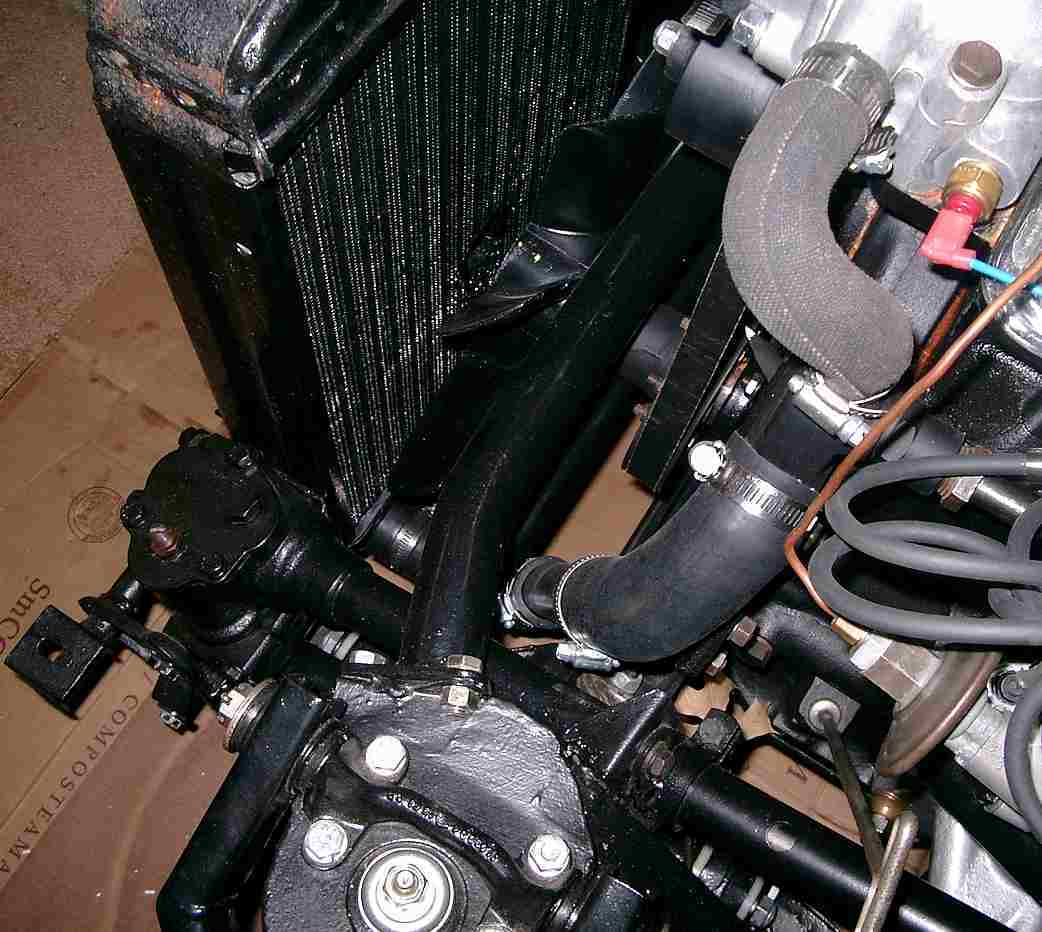

Hi Geo
Here are photos of my install. and a snapshot from Moss catalog. Looks like hard pipe has bend at bottom hose, which is how I am set up. Look closely and you can see how upper hose fouls shock mount. These are TRF hoses, but they are pretty large diameter and hose clamps really have to squeeze and reduce their diameter to tighten and seal. They look like fat little balloons when the engine is at temperature. Any thoughts on this install? Anyone have any photos or description of what I'm doing wrong here?

CinneaghTR
I don't claim knowledge of nor experience with the Belgrove cars, but here's the thread when I went through this with the 4A. It all went down to building from the bottom up and then twisting the pipe toward the engine to clear the frame, etc. Scroll down and you'll see a picture not half as nice as te ones provided by Pat.
Good luck.
https://www.britishcarforum.com/bcforum/u...Pipe#Post688288

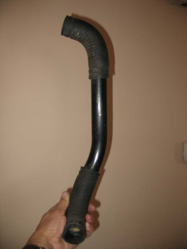

Don Elliott
And here is my pipe. That's the original which came with my TR3A new from the factory. The bend is near the bottom. I notice you have a new rad. Looks nice. Is the lower pipe inlet in the correct place ?

Hey Jer
It looks like maybe I should cut upper hose shorter where it ties to water pump to clear the steering column bracket. Yours appears to have good clearance. Mine is riding on bracket.
