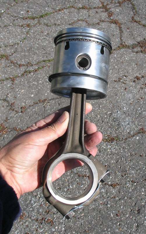

In 1990, I re-built my engine when I restored my 1958 TR3A. I put in new pistons, rings and liners, but kept it all at 1991 cc displacement. I ran that engine 94,000 miles and then did it again last spring. The liners and pistons are the ones that went in back in 1990. I had the bores honed and put in a set of new rings I bought directly from Hastings in Michigan. I paid over the phone with my M/card and had the new rings and all the info in a few days. My pistons are Hepolite from England in 1990 and these have 4 rings. Check your pistons before you buy new rings. If you have or get pistons with three rings, it will be a different Pt. No. for the new set of rings.
